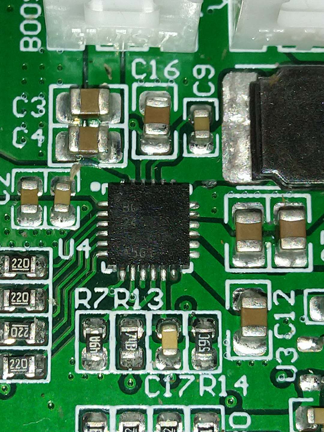

Hello there!
I'm working on a BQ24295 board with 4 layer PCB. Csys = 2x10uF(X5R 25V), Cbat = 10uF(X5R 25V)
Everything seems OK, but when some battery with long cable or high internal resistance is plugged in, charge is OK at const current stage, after the charg current reachs the termination threshold(default 256mA), BQ24295 will keep charging  and STAT LED stat blinking very fast. I add a 100uF capacitor the VBAT pin, the problem is still there.
Also I cannot find any errata info about this chip.
PLEASE HELP.
