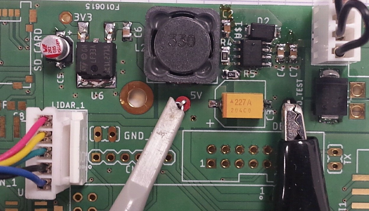

When I switch on the Vin = 24V, without any load, Vout is stabilized at 5V.
With a little load of 100mA, the Vout is still stabilized in 5V.

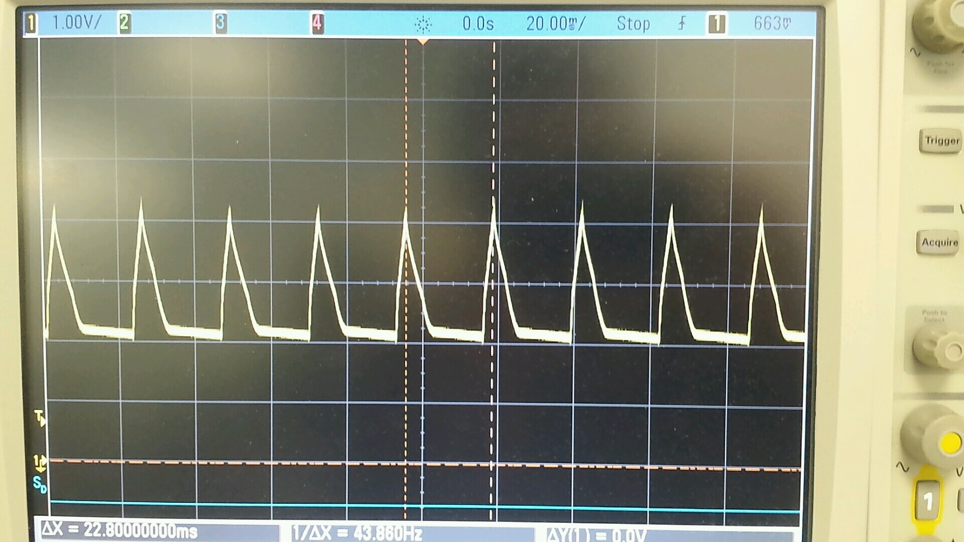

But when I apply a 500mA load, the Vout is not stabilized any more, see the attached picture.

    It looks like it's hitting over current protection and entering hiccup mode (shuts off for 13-20 msec and tries again). Please share the schematic and layout so we can find out what's causing this.

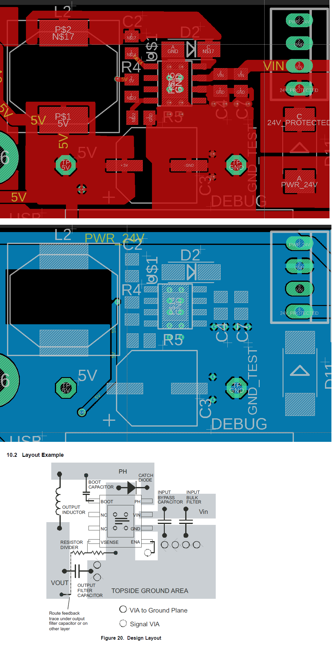

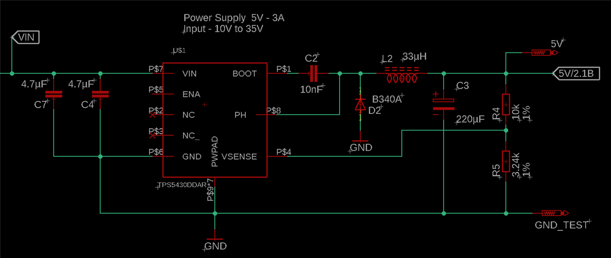

  • Good morning Sam,
    Thank you for your answer.
    Please find the schematic and the layout below:

    Your design does a very good job following the instructions we've given. This is interesting that it has this issue. I have a few thoughts:

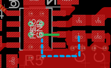

    1. The GND pin is not connected to the thermal pad under the IC. Can you try reworking the board to connect this?
    2. Please confirm that ENA is floating. The top layer looks close.
    3. Try increasing the boot cap to 0.1uF.

  • Sam,
    Thank you again for your analyse.
    1: "The GND pin is not connected to the thermal pad under the IC": do you mean I should do the green path instead of the blue path ?

  • Matthias,
    1. Adding the green path is recommended but probably not what's causing this issue. It is still worth a try, though.
