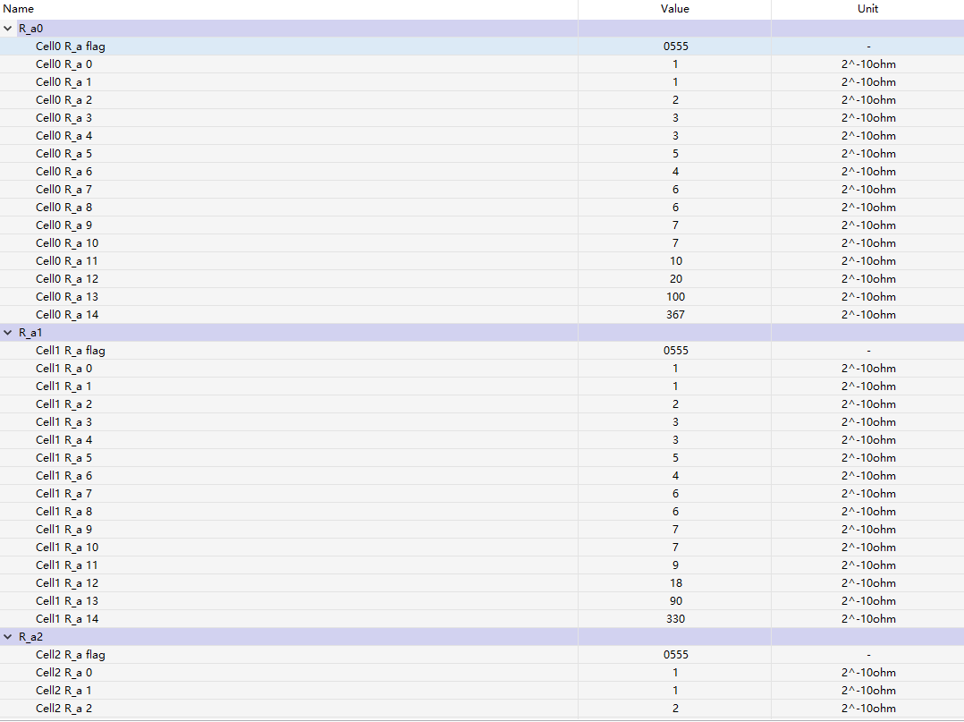

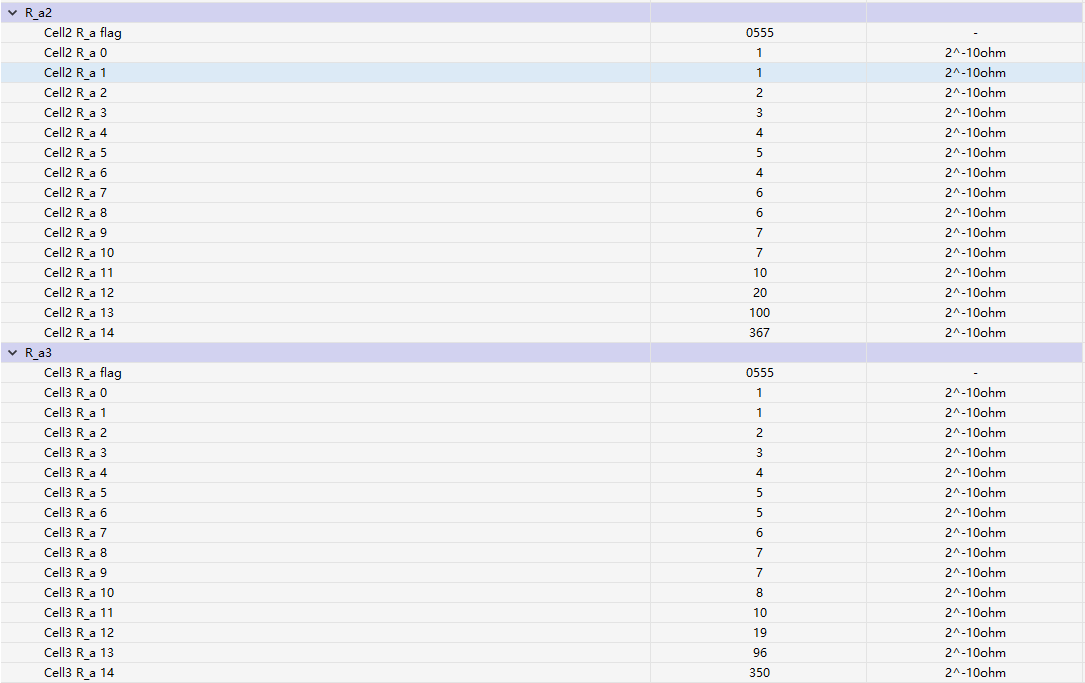

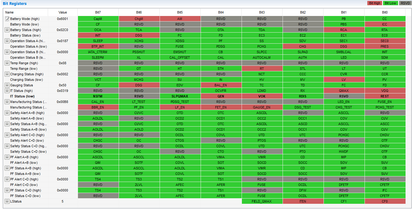

I have done many failed learning cycle with BQ40z80.After the last step,discharge the battery to empty with C/5 rate and relax for more than 5 hours,the VOK never clear,ra_flag =0555, Lstastus=0x05.

Step5: The [VOK] and [RDIS] bits in the IT status() register clear, GaugingStatus[REST] flag is set .
Step6: Charge pack to full with C/2 until the taper current is reached and the FC bit is set.
Step7: Let it relax for 2 hours.( Update status  05)
Step8: Discharge the pack down to term voltage with C/5.
Step9: Let it relax for 12 hours.( Update status  05,vok not clear)In the learning cycle.
Durning step 8,i found the ra table values updated,ra_flag changed form FF55 → 5555 →0555.After step9,Update status = 05,vok not clear.
