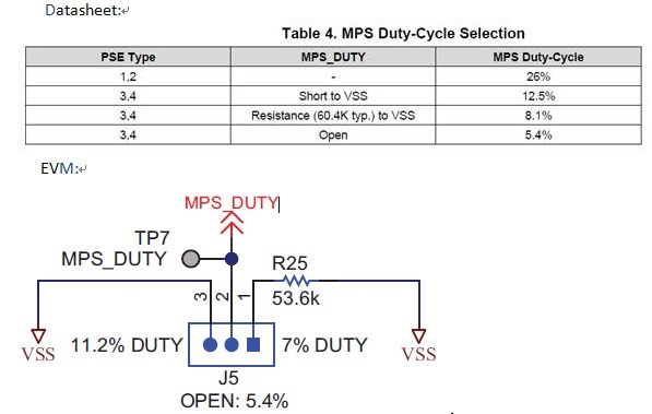

Please see the picture below:
1. the Duty and the resistor are different between TPS2373 datasheet and EVM, which one I should follow?
2. Is this typo? Or any reason?
C.T.
