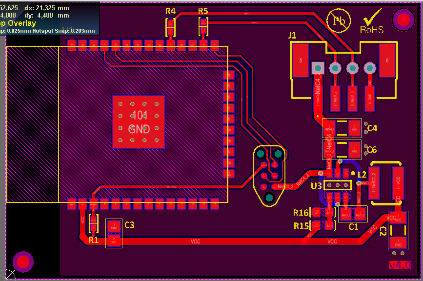

Dear All,
I designed the circuit with TPS562200 that the input voltage is 5-12V and output voltage is 3.3V 1A. I used the WEBENCH Design Tools and TPS562200 datasheet.
I produced the 20 pieces prototip board and 14 boards worked properly. I'm deal with non-working boards. I disassemble processor non-working 6 boards. I noticed that  ground and 3v3 of 4 processor pins shorted.
I think the reason for this is the regulator TPS562200.
I decided to look at the output voltage of the regulators. Although I give the same voltage at the input, 1 of the regulator output 1.66V and the other 4.07 volts. The other 2 one it attracts current in a wavy manner
and gets  very hot.I checked the components wrong and tried again but the components were correct.
As a result, 1 regulator output 1.66V
1 regulator output 4.07V
2 one attracts current in wavy manner and gets very hot.
İs there someone who can help? What could have done wrong. 16 out of 20 working boards.
