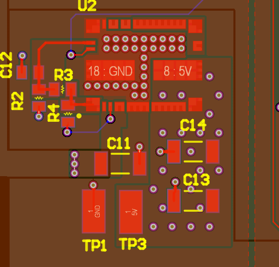

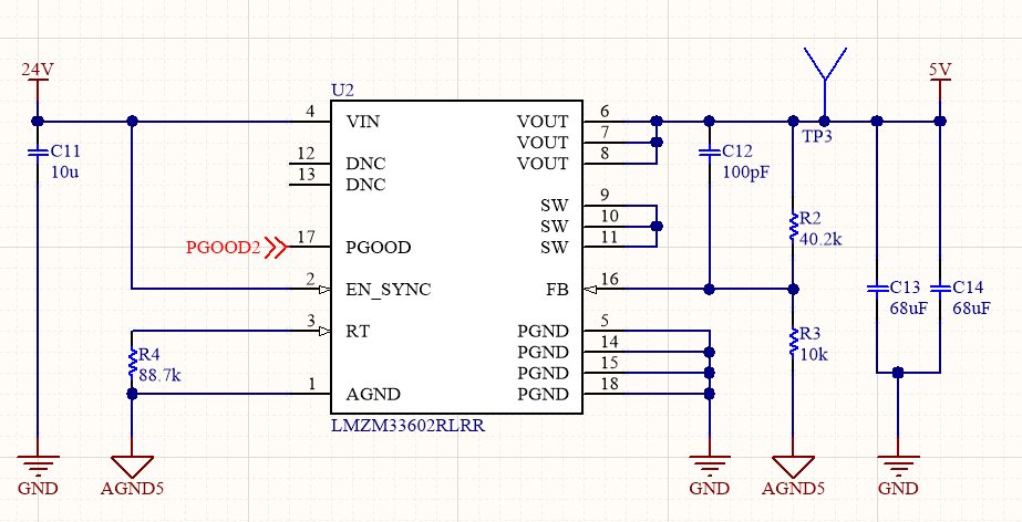

I have created a PCB using the LMZM33602 but I can't get it to output the 5V and I was hoping someone could look over my schematic/pcb do see if they notice anything odd. I am attaching both documents. Thank you!
  • Hi Brittany,
    The schematic looks like it is following the recommended typical component values based on the datasheet Section 8.2.
    Can you confirm that the part does not startup at 5V? If it was able to startup at 5V and PG pulls HIGH but eventually shutdown then I would think it is due to thermal shutdown.
    Regarding the PCB layout, the only thing I'd recommend is to have a larger VIN copper area to help with thermal stress. I see there are multiple vias that connect VIN to the internal layers which is good. The output capacitor grounds are connected to ground through a via.

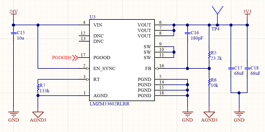

    I was able to test a new chip and it worked. What isn't working is the chip regulating 3V3. I noticed that pin 9, 10, 11 are shorted to 3V3 but that shouldn't affect things since pins 9, 10, and 11 are outputs. I am attaching that schematic below. Maybe something is wrong with that? I apologize for the lack of explanation for the circuits around the chip, my coworker designed the chip and I am just trying to debug it.

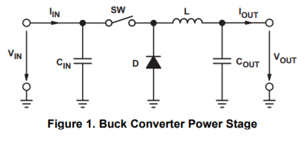

    If I am understanding your debug results, you measured the resistance between SW(PIN 9/10/11) and 3V3(PIN6/7/8) and observed a short? This is a problem since SW comes before the internal inductor (L) and VOUT comes after the inductor. Attached below is a typical step down converter topology.
    Similar to my comment previously, the schematic for both 5V and 3.3V looks like it follows the recommended typical values in the datasheet. Just throwing it out there, is VOUT accidentally connected to SW on your board through a solder bridge? If you remove the device off the board and ohm SW and VOUT do you still get a short? This would tell me if the internal circuit is damaged causing the device to short VOUT to SW or if the short occurs on your board which could lead to a SMT assembly problem. Also did you see the same symptoms on the 5V circuit where you weren't getting any output? Having SW shorted to VOUT would definitely cause problems for the converter to regulate anything.
    Jimmy
