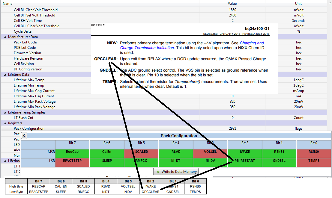

  • The bq34z100G1 chip's "Pack Conifiguration" register has a PB_RESTART bit 2 which is listed and described as QPCCLEAR when using the battery management SW.  The FW rev number for the gas gauge chip is 0100_0_16-bq34z100G1.  I suspect when the data sheet was written the FW was an earlier revision and the bit got reassigned without the data sheet being updated?  I am attaching a print screen of what the tool says and what the data sheet says.  I have not been able to find a description of what the PB_RESTART bit function is and so I do not know how to set it.
  •  I Iam reattaching the screen capture picture since I am not sure it got uploaded.
  • Hi Richard,
    Thank you for bringing the discrepancy to our attention. PB_Restart operates in the same way as QPCCLEAR. The feature clears Passed Charge that may have been accumulated towards a Qmax update when the gauge exits the relaxation state, if a DOD point has been set. This helps to prevent errors in the Qmax estimate due to the way that voltages of some battery chemistries, such as PbA, relax after charge and discharge.
