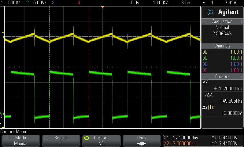

I am testing LM2596-ADJ Chip in Lab using the following board module,
I purchased this step-down module from here
The lab reading shows the switching frequency of the device to be around 49-50 kHz in any load condition it is tested (checked for 500mA - 1.2A). 2 Test reading snaps given below.
But the datasheet(datasheet link) says that the frequency of operation is around 150kHz
Could you please explain this difference in behavior?
