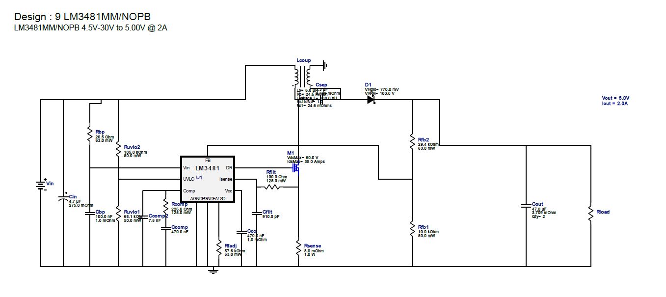

Hello
I used the WEBENCH to help me in the design of a power supplu for the uBlox-Sara-U200 cellular module (picture above).
The ideia is to power supply the board, between 4.5 and 30V with an output of 3.3V @ 2.5A (maximum).
I intend to use the same model, but this time, to have an output of 5V @ 2A (maximum), with the same voltage input from 4.5 to 30V. The WEBENCH design didn't show-me this model for this voltage ouput. However, in the datasheet of the LMR33630. says that I can have an output of 5V. It presents the second desing that i post here. Is there anyway of using the same model as the first one? Or because the voltage from input is too close to the voltage of the ouput that is not recomended.
Best regards
Pedro
