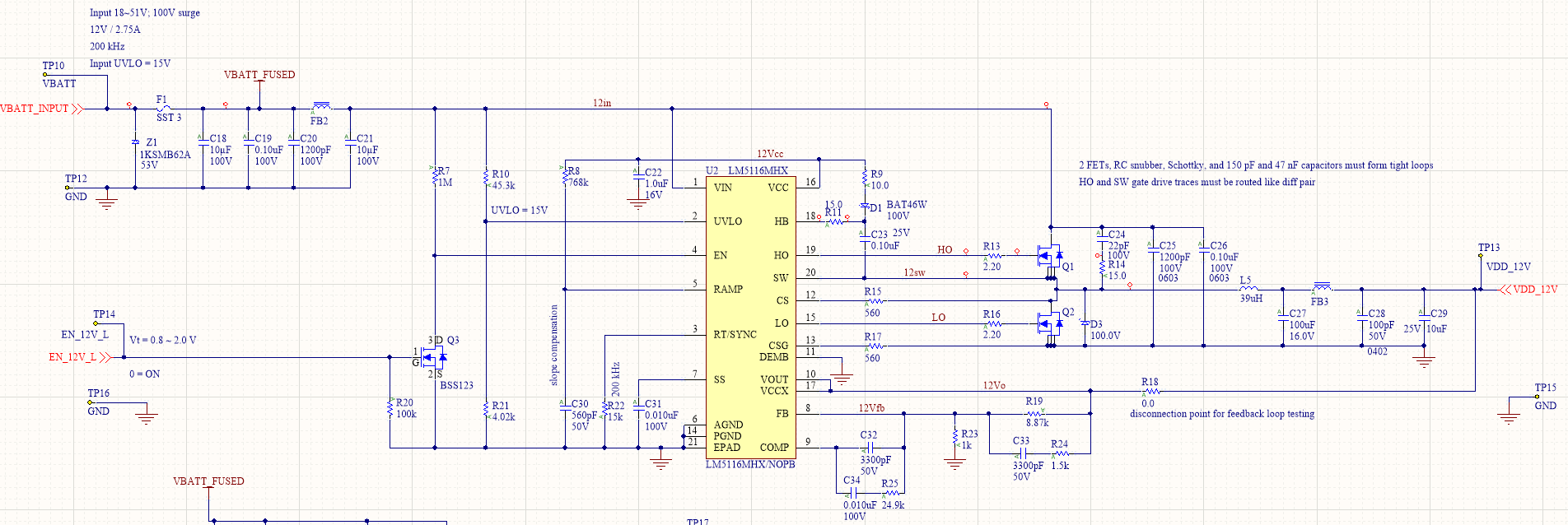

I have a buck converter using the LM5116:
18-51 V input
12V / 3A output
I get an output oscillation that occurs at a narrow band of load current, at light load. The current at which it happens varies according to input voltage. It happens right when the converter is in borderline CCM/DCM.  I have the part in diode emulation mode.

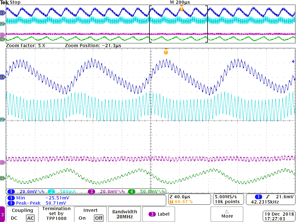

The waveforms below show choke current, and output ripple voltage (AC coupled). Load is 0.4A and input is 25 V.

  • Jason,
    Please share the schematic.
    Please also share this same scope setup with FB on CH3 and COMP on CH4.

  • Please see below.
    From top to bottom:
    - output voltage ripple
    - choke current
    - FB pin
    - COMP pin
    It looks voltage-modey in that the choke current lags the COMP pin by 90*.  More specifically, once the choke triangular current "touches" zero (DCM), there is a lag of about 10 switching cycles from when the COMP pin begins rising, and the current begins rising up.  At the peak of the current waveform (CCM), there is only about a 3 switching cycle lag from when the COMP pin begins dropping, and the current begins dropping.
    I did a step response test at heavy load (CCM), and the lag is only 3 switching cycles, so it looks much more like current mode.
    Schematic:

  • Hi Jason,
    The lead network across the upper feedback resistor is typically not connected for a current-mode controller. Please forward a completed LM5116 quickstart file for your circuit (this Excel file is available by download from the product folder).
    The DEMB resistor is normally 0 Ohms to enable diode emulation mode. Does the oscillation appear if diode emulation mode is disabled?
    Tim
