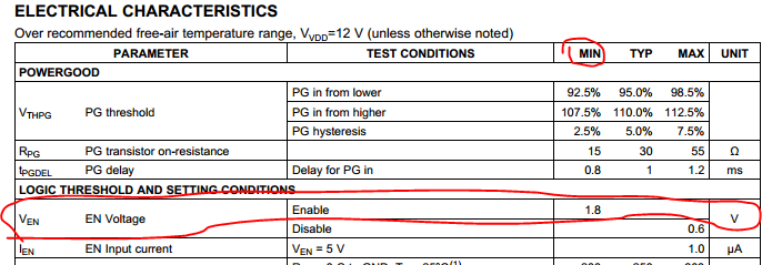

For the EN of TPS53355, datasheet gives different requirements below. what's the meaning of the 1.8v below? whether it's max enable on voltage? Which value we need to follow 1.8v or 1.2v. Thanks.

I'm sorry for the confusion of the unclear specifications. What the 1.8V means is that we guarantee the part to be ON at 1.8V and to be OFF at 0.6V. I hope that makes sense to you.
