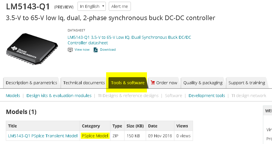

If it could be stable over this wide output range must be checked.     So I started with a Simulation, based on the LM5143-1 model and parameters calculated with the quick start design tool.
The simulation run well as long as the output was fixed to 5Vout (FB1 at gnd). If I replace the gnd connection of FB1 and replace it by a voltage divider (90k/10k --> 6Vout) the simulation fails.
LO2 keeps low during switching and after SS reaching 0.6V the Output 2 was interrupted.
Qould this be a Problem of the model? I have'nt read that this Feature (interleaved with variable output voltage) is not implemented.
