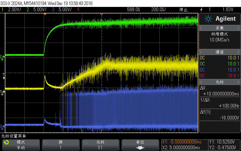

Hi Sir,
i used LMR14020-Q1 to design a power suplier, Input:12v; output:3.3v/1.2A, but when power on and power off , the output voltage  will have a  1.3v voltage spike as  the attachment;
i want to konw the reasons and how to solve this issue, the voltage will restar our MCU.
