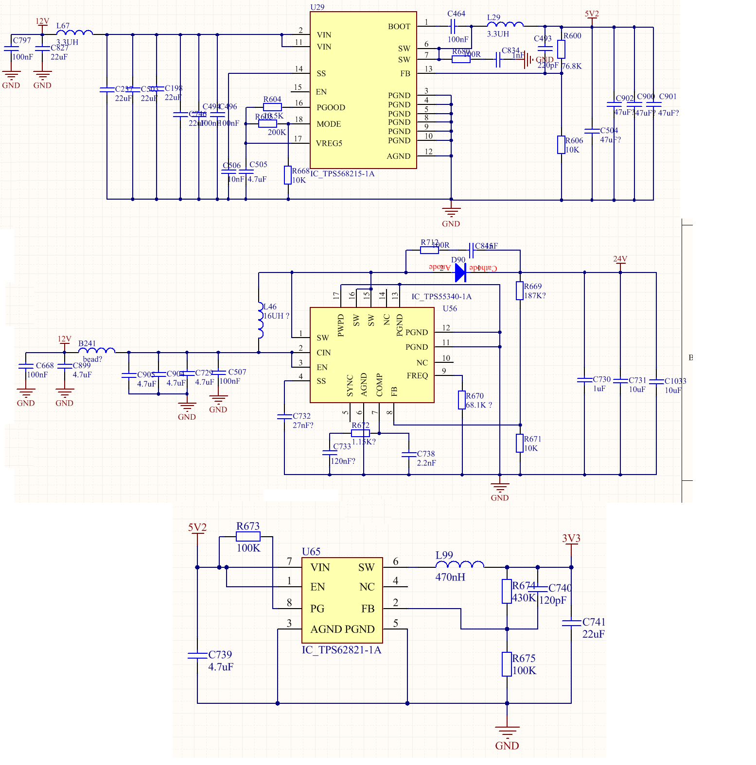

I use tps55340 as boost circuit: 12 V  ----> 24V  0.5A . efficiency>90%
  use tps568215 as buck circuit: 12 V  ---->5.2v  3A.   another Buck circuit tps62821: 5.2V  ---> 3.3V 1A
  4 Level  pcb layout.   Schematic;     Product:

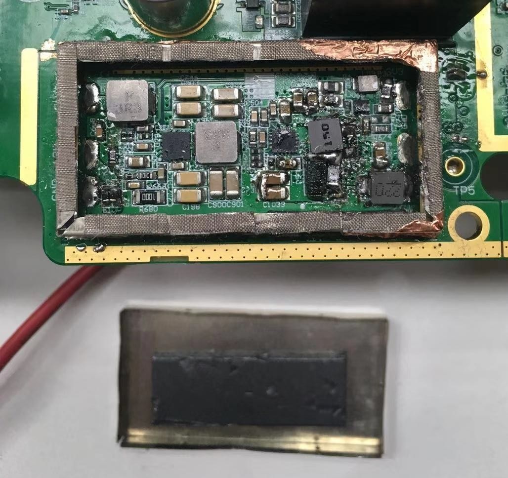

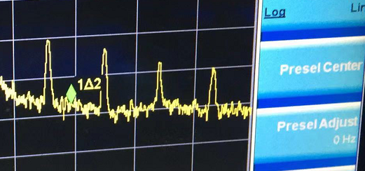

but  when i use Spectrum Analyzer detect the surface, Interference signal energy is large. (the wave1).
so i covered with Shield, the energy become lower but still have some glitch when detect on the shield surface。
i found the interference form TPS55340.

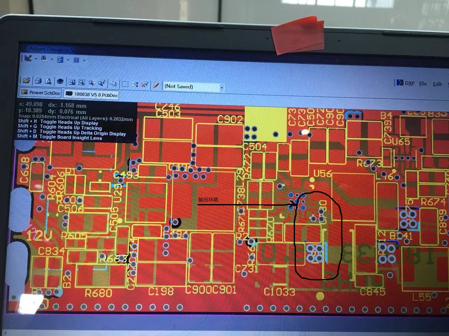

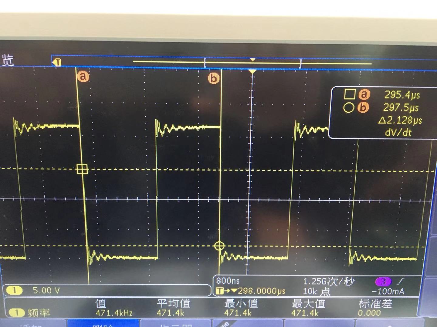

TPS55340: SW Waveform is not very bad( the wave 2.), the pcb Layout  (The wave 3.) the freq.=460K
i have try some measurement  But  it can not finished the problem.
1. adjust the cap and resistor on the diode D90,  cap: 10p---->1nf
2. add inductance  15uh on the output pin .
3. connect a bead on the diode D90.
Does the GND Net shout be optimize or not ? or give some advise .
