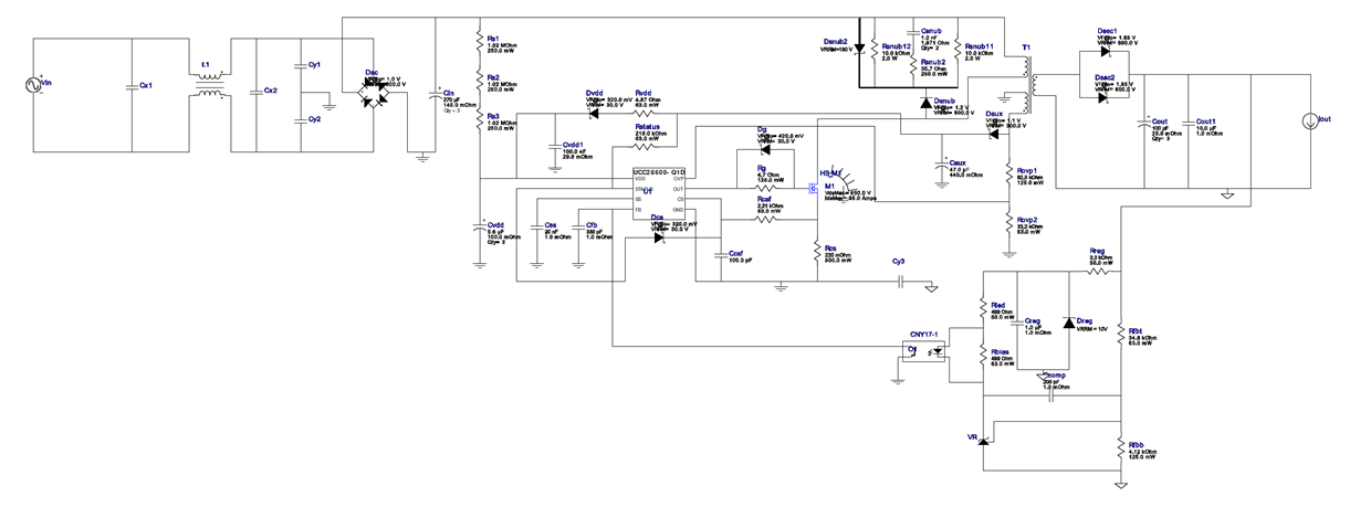

Hey, I want to design a flyback with the ucc28600 with an input voltage from 40VAC to 265VAC and a ouput voltage of 24V (40W). I use and instead of a start up resistor a linear voltage regulator.
The circuit in the webench software doesn’t work and the feedback circuit of webench makes no sense. So I tried the excel document with the feedback circuit from the 65W evaluation module. But it doesn’t work too. It only works from about 40VAC to 65VAC over the hole output power range. I measured the feedback pin and it discharge the feedback capacity every cycle completely. Could this be the problem?
At an input voltage of 65V and a output of about 20W the output voltage is flatting between 24v and 15V.
With increasing input voltage the IC only works with decreasing the output power and stops working immediately after the output reaches the output voltage of 24V for the first time.
Isn’t it possible to design a flyback with this IC over the hole input voltage range or what could be the problem?

  • Thank you for your fast feedback. Attached you can find the excel document I used to calculate the values.
    The transformator has the following values:
    NPri/Sec=5
    NPri/Bias =10
    LP = 109uH

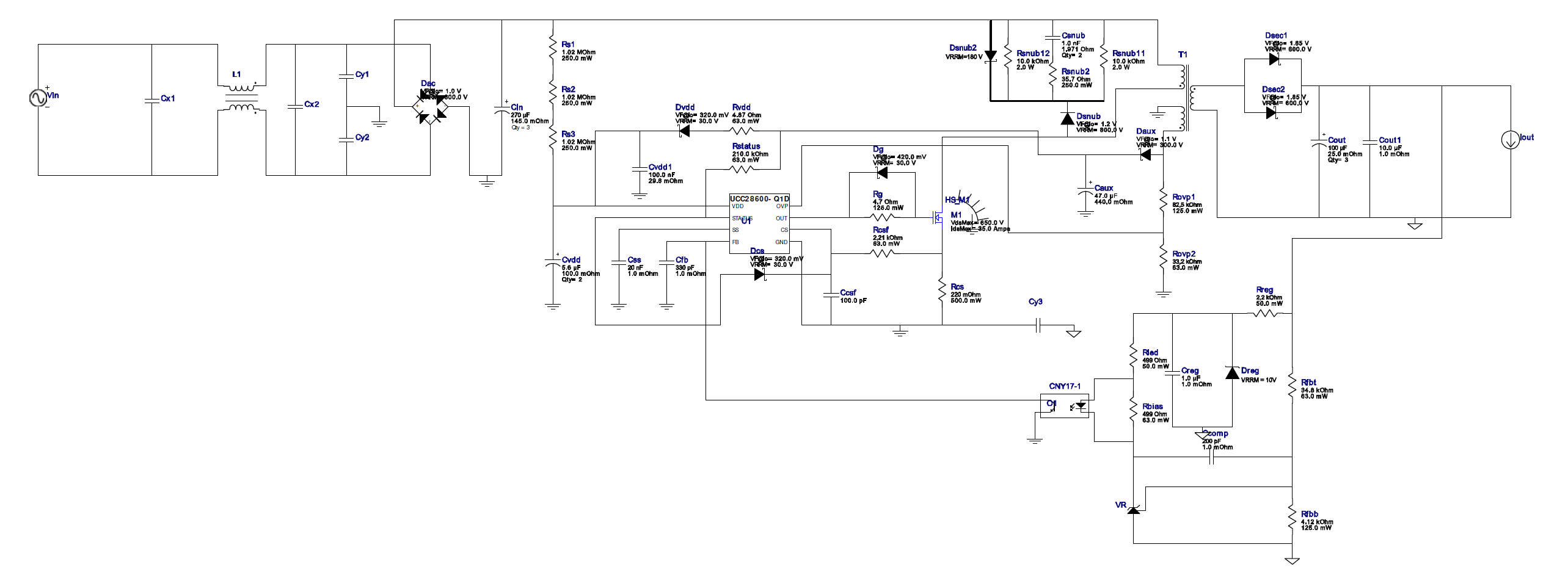

    The circuit is nearly identical with the following circuit. Only the startup circuit RS1, RS2, RS3 was changed by the linear voltage regulator, which delivers a constant voltage of 14V.

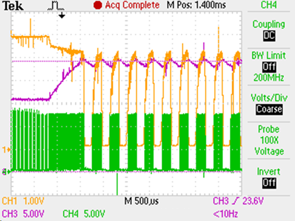

    The problem I mentioned above was, that the voltage at Cfb is getting down to zero every cycle. The following oszi screenshot shows this problem. It was taken by 66V and about 40W output power, but this problem I have by lower input voltages too.
    CH1=Cfb
    CH3=Output Voltage
    CH4=Gate Voltage MOSFET
    The trafo was coiled myself and it is sometimes noisy. Could the trafo be the cause for the problem? Is the circuit in principle correct? Can you say me, what I have to change, so that it works?

    Looking at the FB signal behavior, this looks like a large-signal instability. I assume that VR in the schematic is a TL431 shunt regulator.
    (If it is something different, please let me know.) The compensation cap Ccomp is only 200pF. Normally, I'd expect this value to be much larger (at least an order of magnitude or more), sometimes with a series resistance. This may be the main cause of the instability, but there may be other contributors.
    I'll step through the design calculator and verify that the values make sense and that the schematic matches it.
    The audible noise from the transformer is probably from the on-off nature of the unstable operation seen in the screenshot.

    A review of your Calculator spreadsheet shows no significant problems. The schematic diagram that you provided appears to have been generated by the Webench design tool. I think that some of the components recommended by Webench are not the optimal choices for the application, but they are not the cause of the unstable operation that you are experiencing.
    I believe it is due to improper loop compensation values, particularly Rled and Ccomp.
    Please refer to this design guide to redesign your compensation network properly: www.ti.com/.../slua671.pdf
    I hope this resolves your issue.
