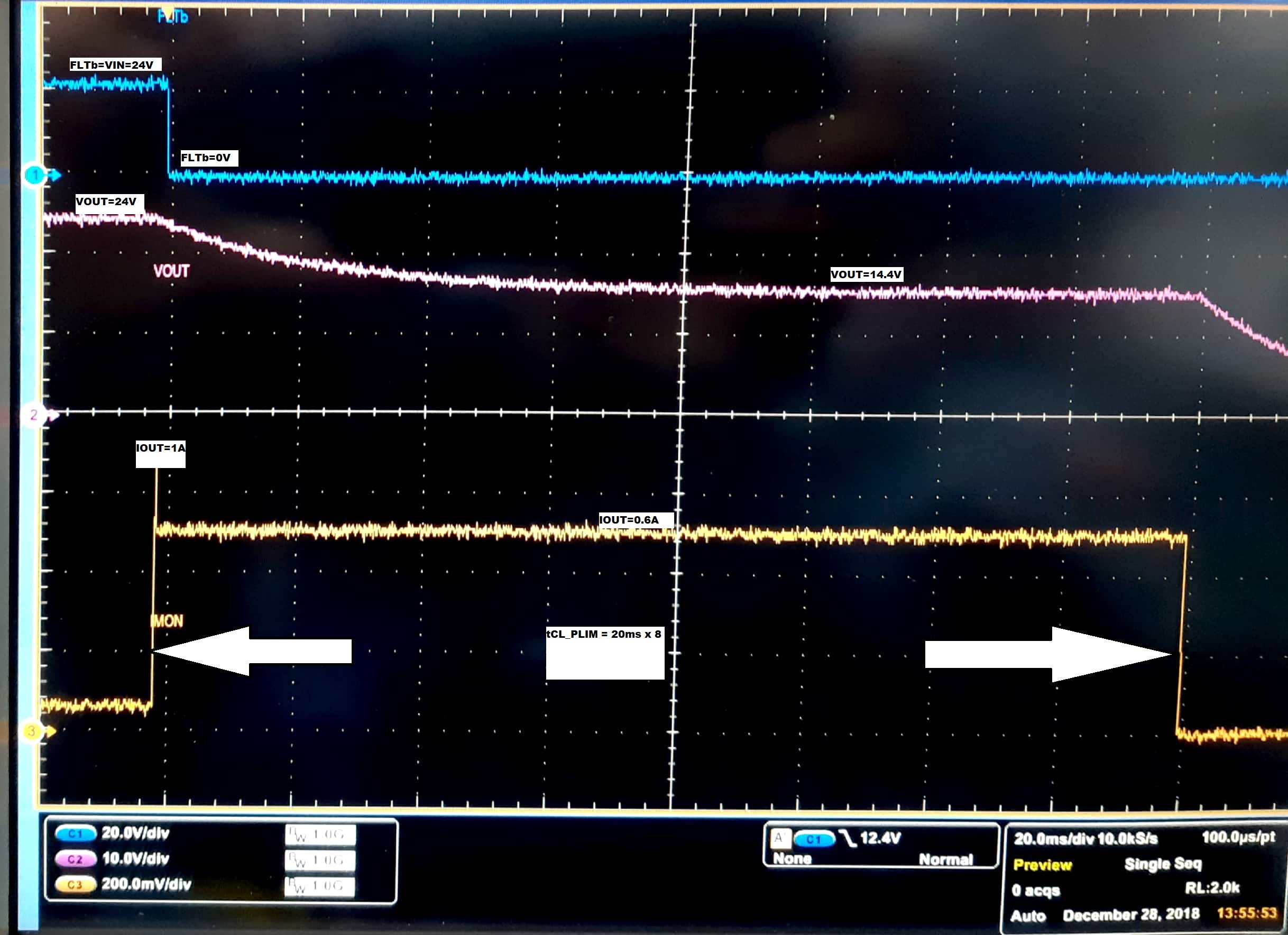

  • Hello Magnus,
    As per test done on EVM with 0.6A current limit, 24V Vin and 24ohm load on output, tCL_PLIM is ~160ms. Please see below scope capture.
    For this test, a load of 24 ohms was connected on OUT after VOUT has reached VIN (24V) with current limit of 0.6A through Jumper J4 on EVM.
    Can you share the test conditions (VIN, Load resistance) and waveform for VOUT, FLTb and IMON captured on a oscilloscope?
    For section 10.2.1, the thermal regulation timeout (on start-up) will be fixed in released version of the device.

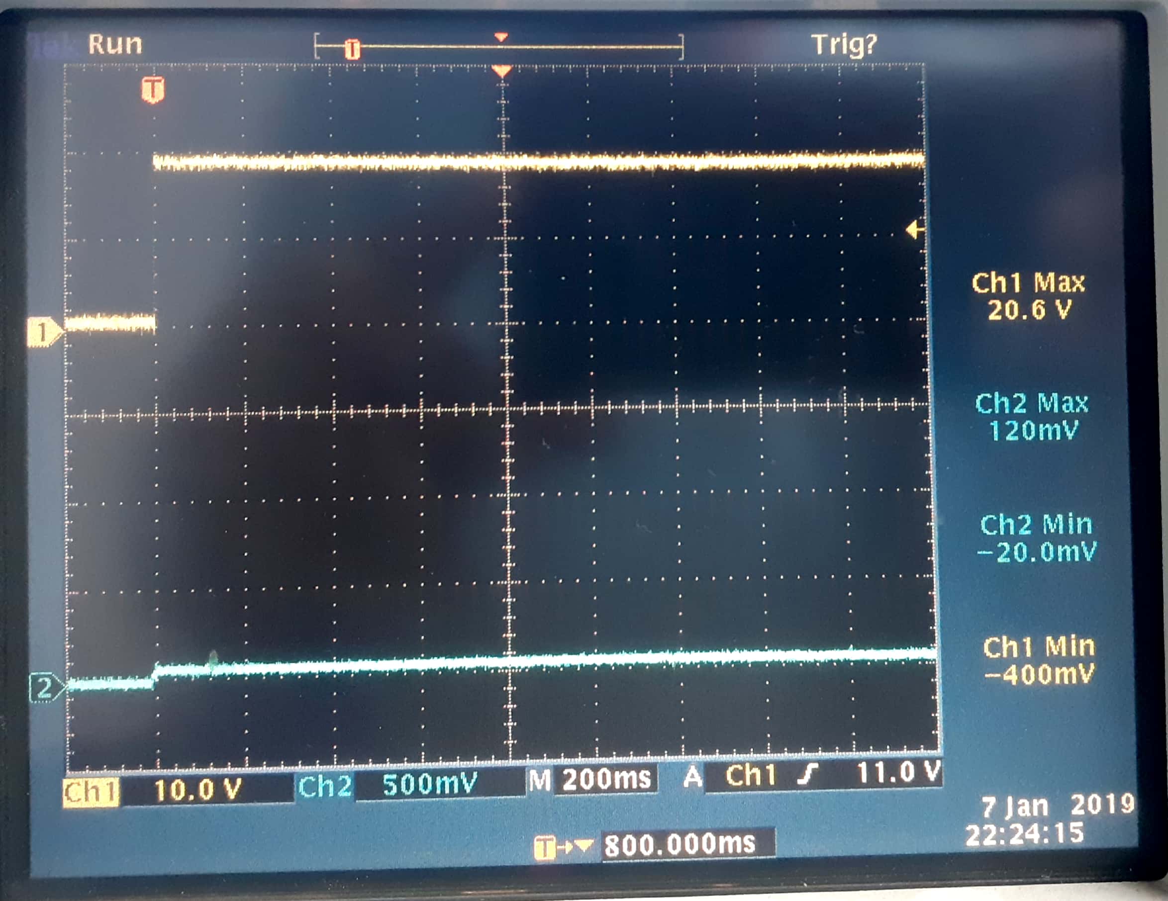

  • Hello.
    Please se 'scope picture below. Signals and "DIV's" are in the same order and scale as you have them.
    The FLTb1 never drops and the IC is going hot. FYI I have removed the large output cap.

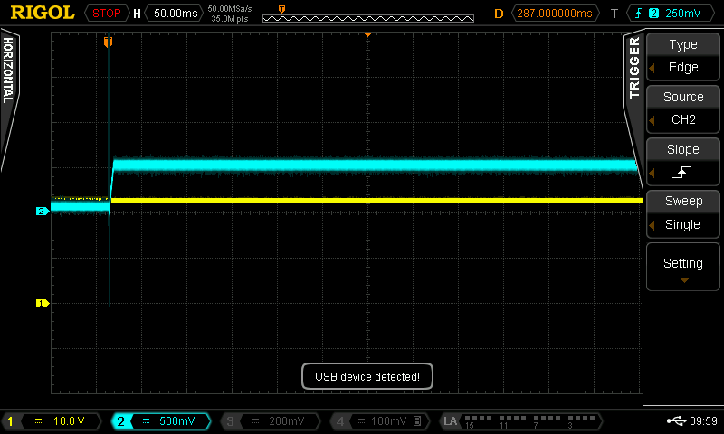

  • Hello Magnus,
    Please refer to below for auto-retry behavior with over-current of 0.85A for ILIM set to 0.6A. The device auto-retires and fault is set to high after the over-current condition is removed. There was no effect on touching TP2 (SHDNb).
    Was the ILIM voltage decreasing with decrease in input current in your above observation?
    Device in auto-retry CH1 = FLTb, CH2=IMON
    FLTb goes high after the over-current condition is removed [CH1 = FLTb, CH2=IMON]

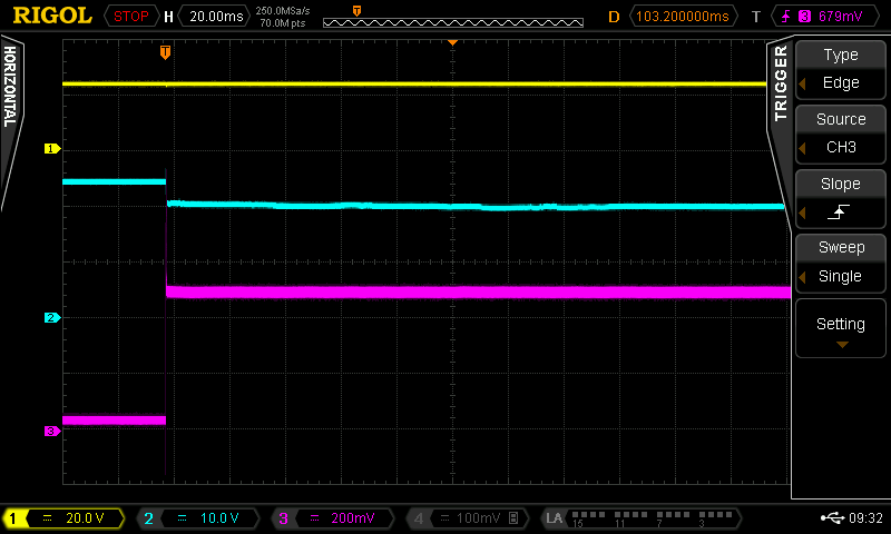

  • Hello.
    When measuring with multimeter, ILIM was slightly decreasing as the IC was heating up.

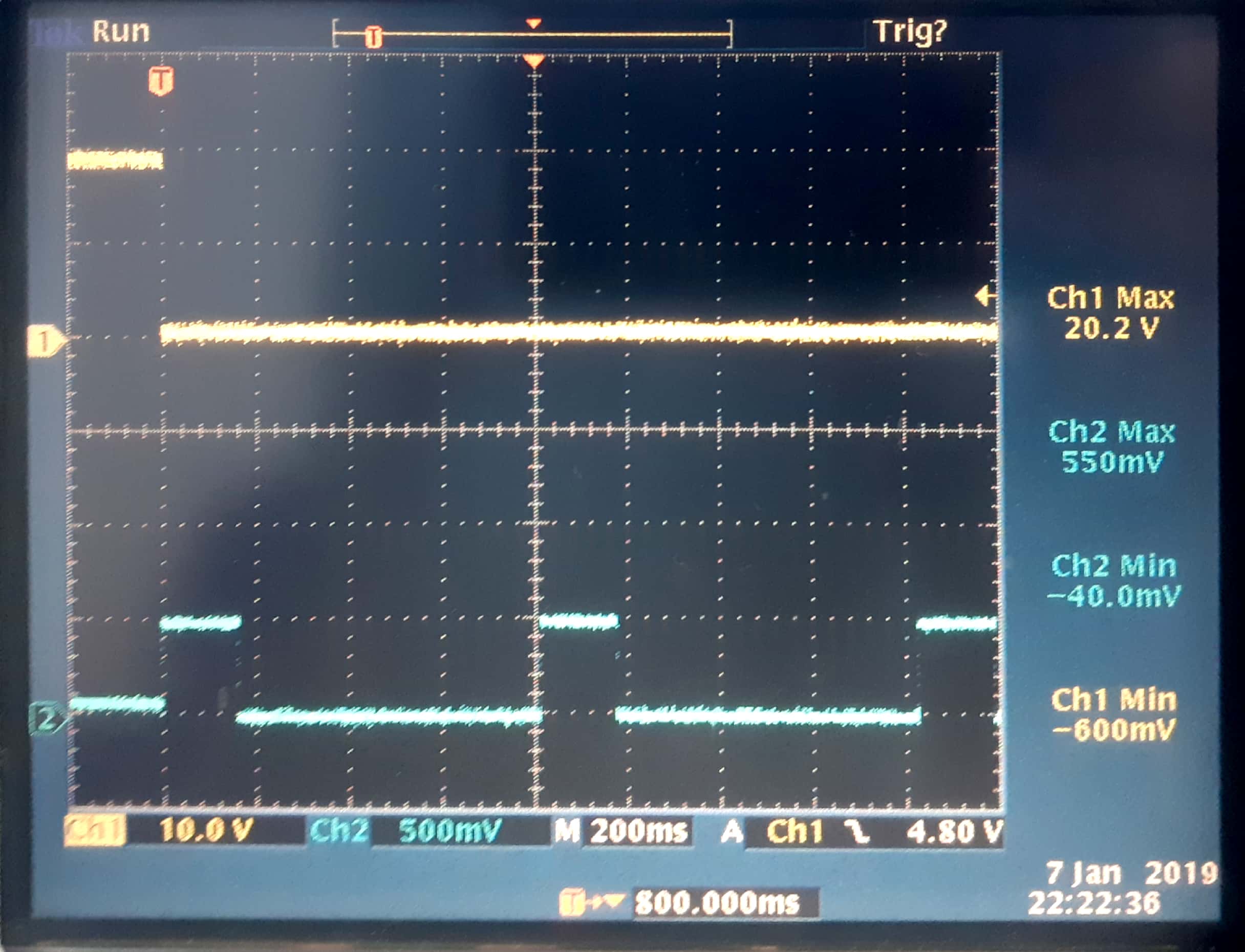

    I do not get this behaviour. See my picture below, where TOP=Vin, MID=Iout, BOT=FLTb.
    The sensitive SHDN was in manual mode, not auto-retry. I touched this test point while resting my other hand on the electronic load chassis. This combination made the IC to reset. The LED was indicating RED, but when I touched the test point, it changed back to GREEN. Does the pin require a pull-up?
  • Hello Magnus,
    There seems to be some interference or inconsistency from the electronic load. it looks like load is pulsed as you can see in blue waveform above.
    Can you try testing with a passive resistor (20-30 ohms).

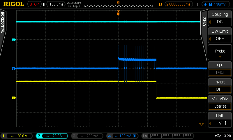

  • Hi.
    I have tried with 28R power resistors. The pulses we saw is now gone, but it still only triggers for overtemperature. See picture with IMON (cyan) and FLT (yellow). Eventually (several seconds later when temperature is high, the LED's changes from green to red).
    I also tried the other channel with the TPS16632 (same marking as TPS16630) with same behaviour.
  • Hi.
    I have until now been supplying from a PoE (802.3at) splitter with 24VDC output. When I change to a lab PSU it works, and I get the 162ms.
    But the 24V output from the PoE splitter is nice and stable, even in the 28R connection transient.
    I did some experimenting and found that the IC needs more input capacitance to work with the PoE splitter. The 1uF on the EVAL board is not enough if suppplied from something else than a laboratory PSU. 10uF seems to work well. I think you should update the datasheet with this.
