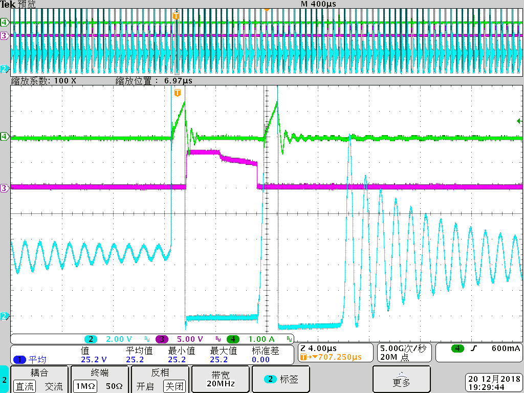

I follow the UCC28780EVM for an adapter design, and UCC24612 is used as the secondary SR driver.
I found the PWM_SR failed for the second pulse as below.
Could you help explain why the second pulse failed?
CH2:VDS; CH3:VGS; CH4:Ipri

    I wonder if VDD had enought voltage on the second pulse. Could you take a look at VREG and VDD along with these waveforms. It could be that you the design may not have enough capacianctance on VDD and VREG.
    Mike

    One of my colleagues discussed the issue with me that you were having the UCC24612 and he let me know that in burst mode the UCC24612 could actually skip pulses under certain conditions.
    From DS page 18:
    “UCC24612 sets up the off blanking timer based on previous cycle's SR off time. By choose 70% of previous switching cycle's SR off time, the off blanking timer is maximized to prevent any false triggering.”
    >Maximum off time is 3.68us.
    From DS page 20:
    If for any reason the off blanking time expires after the SR body diode conduction, the SR turning on is skipped for the switching cycle. This is because when the SR conducts, it conducts with a minimum on time, if the blanking time expires at the end of the SR conduction time and converter operates in the CCM condition, there is a good chance to cause shoot through the endanger the converter.
    Since the previous burst happened some 100us earlier, controller sets the off-time blanking to 70% of 100us, except it maxes out at 3.68us.
    Since this burst’s 2nd pulse on-time is only about 1.5us, the off-timer (3.7us) from the 1st pulse has not expired yet at the 2nd pulse turn-off point so it triggers the response highlighted in green.
    The 1st pulse of the next burst then works okay, but it’s 2nd pulse gets the same treatment as above.
    That’s why you sometimes see a missing SR at the 2nd pulse of a multi-pulse burst.
    Mike
  • Hi Mike,
    Thanks for your detaled analysis.
    So it is a normal phenomenon for UCC24612 in this mode, right?
