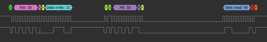

So, naturally, I read two bytes from State of Health command and got 0x160 == 352%. I thought it can't be right so I went to BQ Studio and read all values in there. State of Health was shown as 96%.
Then I used logic analyzer to see how Bq Studio reads this command. And I saw this:
That is a one byte read. 0x60 is indeed 96 percent. I made two reads and I read lower byte 0x60 (which was correct) and then I read higher byte 0x01 (which is not).

  • State of Health is of data type U1, which is unsigned int 1 byte. The data immediately following it is SOH status which per TRM gives you what type of state of health reading was taken.

    As per SLUUA97:
    StateofHealth( ): 0x1C and 0x1D - so reading 0x1C should give State of Health, doesn't it?
    But this is followed by your quote (more or less) and I don't really understand what are these 0x29 and 0x28. I was reading command 0x1C, not 0x28.
    And can you please point me to where in documentation it is said that State of Health is of data type U1? Tables 4-3...4-10 do not directly mention SOH and Table 4-2. Data Type Decoder - wich defines type U1 - in my view describes only types in the internal flash. I can't see any direct relation to I2C commands.
  • 0x1C and 0x1D are 28d and 29d in decimal. You're reading 2 bytes, SOH is combined with SOH Status. So when you read 2 bytes, both are returned, 1 byte for SOH and another for SOH Status.
  • I'm sorry but it is written 0x28 and 0x29, even you wrote it that way. And 0x usually stands for "hex", not "decimal".
    I believe thats a misprint in the documentation and it should be corrected.
  • Yeah, you're right.
  • Okay, than I think this issue is resolved. Thank you for your help. I hope this misprint will be fixed :)
