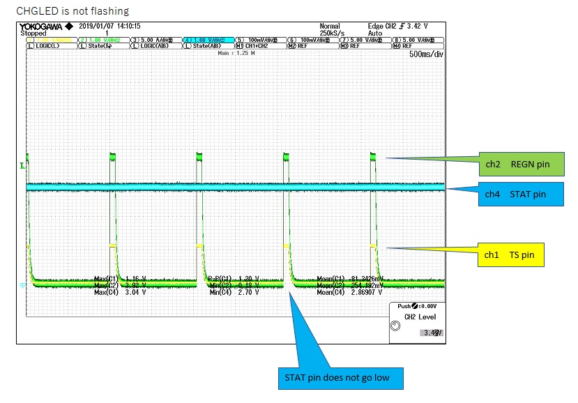

    Let's do one thing then. Capture a waveform of the following:
    STAT pin oscillation
    TS pin voltage (as measured as close as possible to the pin of the charger)
    REGN voltage (as measured as close as possible to the pin of the charger)
    You also mentioned this behavior is not consistent. We expect that no TS fault will be present in battery only mode unless you are operating in OTG (reverse boost) mode. The TS fault is only meant for either charging mode or OTG mode.

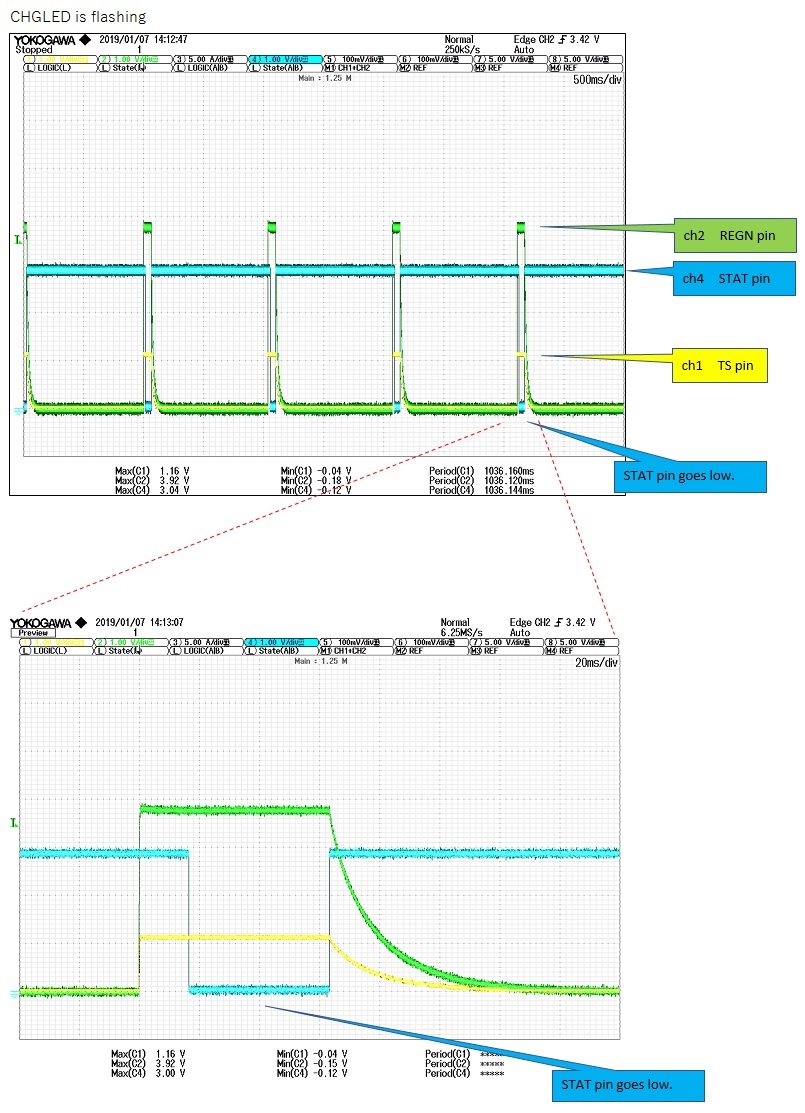

  • Hi Joel,
    This is a waveform when the LED is flashing. Hope this would help.
    On the contrary, this is a waveform when the LED is not flashing.
    Hiroaki Matsukawa.
  • Hi Hiroaki,
    We were able to replicate this behavior as well. We recommend to use/set "One-Shot" for ADC measurement.

  • We got the same results. An alternative but nonideal solution would be to ignore the STAT pin whenever the charger is supplied by battery only. REG0B (Table 20) indicates if an input source is connected or not.
    This information is something we will be revising and updating the datasheet with.
    Alejandro
