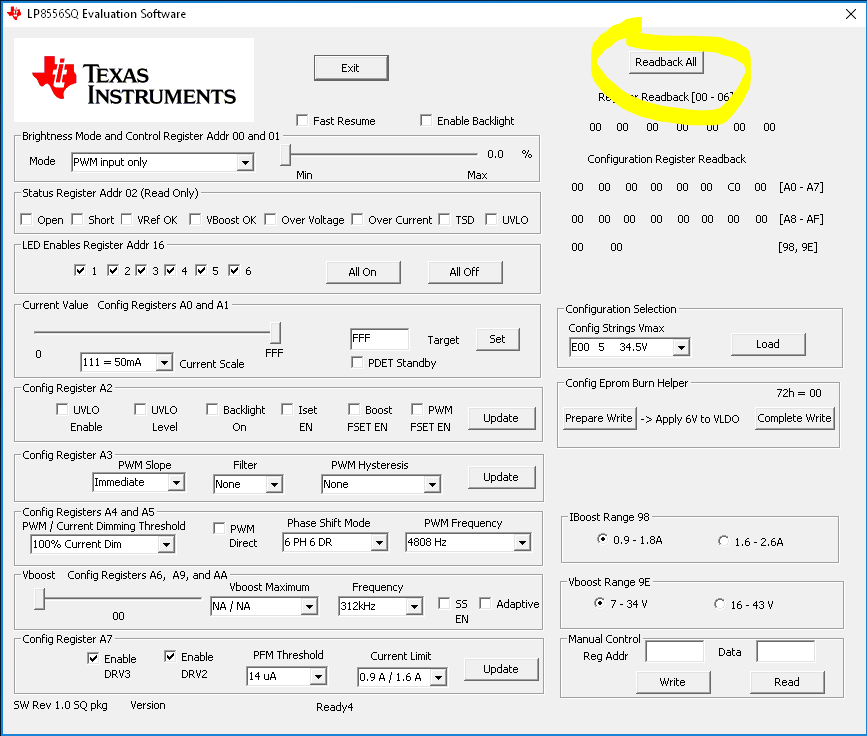

  • Hi Fandy,
         No, LP8556 don't need unlock first, could you use our GUI to check whether you can read the regs has changed after you change the regs as bleow:
    Sean

  • Hi Sean
    We think we have found the problem about no adaptive boost voltage regulation, it maybe need disable un-used led string, because my application is LED5,LED6 unused, after changed Reg A16h from default value 3Fh to 0Fh ,then it could adaptive voltage regulation.
    but about Dimming type, strange thing is it could be both PWM and I2C dimming with no change Reg 01h(BRT_MODE)
