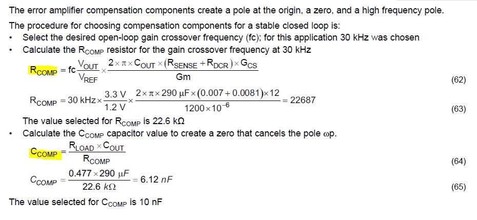

1. When using this device in the interleaved mode, how do I calculate Rcomp and Ccomp?
Cout - Should I use the total capacitance on both phases?
Rsense, RDCR - Which value should I use? The value on either phase?
Rload - Should it be (Vout/total Iout)?
2. Does the "LM5140ADESIGN-CALC"  tool work for interleaved operation? It seems that it treats my inputs as a dual-output application.
Thanks!
Roy Hsu
  • Hi Roy,
    Just use the per-phase equivalent circuit with the total output cap divided by the number of phases. The LM5143-Q1 quickstart calculator is configurable for 2/3/4-phase operation and can help you with compensation component calculations - it's available in the product folder. The parameters as essentially the same as the LM5140-Q1.
    PS: I recommend using the LM5143-Q1 as it is a true current-sharing multiphase controller (no external op-amp required).
