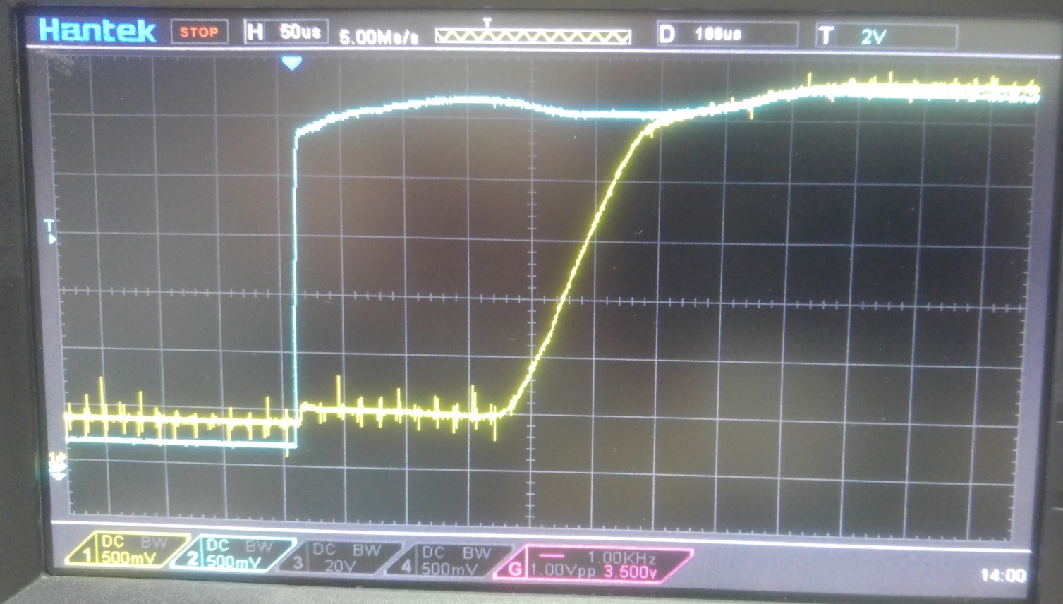

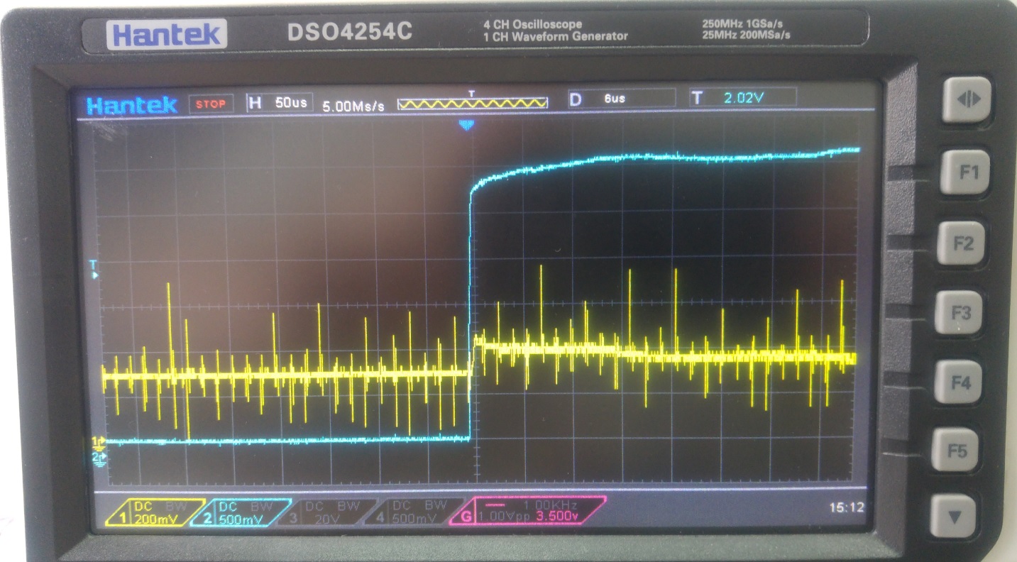

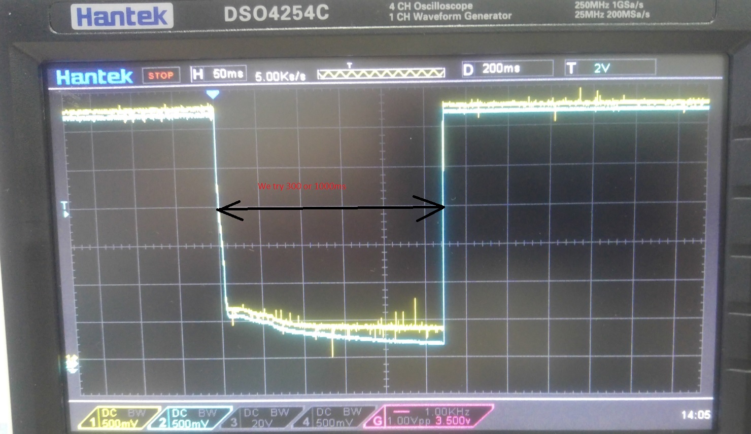

  • Hi Kari,
    Still in part of devices TPS22946YZPR I have problem.
    Replacing devices solves it.
    I remind that I switch device off, wait 300ms or 1000 ms and switch the device on by switching on +3.3V.
    On attached waveforms blue is +3.3V input and yellow is an output
    On picture TPS22946YZPR_NormalOffAndOn.jpg you can see our normal case and TPS22946YZPR_NormalOn.jpg is normal case zoomed to switch on time
    On Off300msAndProtectionAfterOn.jpg you can see that after switching input on what happen with output.
    Manual Replacing elements solves this problem but because it is BGA I do not know if it is an element problem or soldering problem.

  • Hi kari,
    I still waiting for answers to this urgent issue.
    Please note that it is a discharge resistor 1MΩ between +3.3V input and ground. If I replace it to 100KOhm it looks (I am not sure) that it solves problem.
    But I do not understand why.
    Please advise for all my questions.
    Shlomi
  • Hi Shlomi,
    Thanks for reaching out on E2E! Kari has been filling in while I was away on vacation, thanks for being patient as many of us are returning from holidays.
    After taking a look at your configuration, the issue might be due to connecting the ON pin and VIN together. When both VIN and ON are tied together, the controlled slew rate for the device cannot be guaranteed because the device has not had sufficient time to power up. Furthermore, the TPS22946 and other current limiting load switches would not be able to control the inrush current since the circult limit circuitry isn't active until the part is fully powered on.
    If you want to keep ON connected to VIN, you can try adding an RC filter between VIN and ON. The delay time between VIN and ON should be at least the turn on time for the device (tON). Otherwise, is it possible to separate the VIN and ON input supplies?

  • Furthermore to my previous post on figure 22, 23 datasheet Vin and Von rise simultaneously
  • Hi Shlomi,
    If controlled slew rate isn't a concern, then connect VIN and VON is ok. Another potential concern is from soldering the BGA package. You mentioned that manually replacing the devices fixed some of the issues.
    If the incorrect nozzle force and mounting techniques are followed, this could lead to chipping and/or incorrect performance. How are you soldering the devices to your production board?
    Please refer to Mounting of Surface Mounted Devices for guidelines on soldering the TPS22946. For this device, I recommend using 120-125 gf.
    Arthur Huang
  • Hi Arthur,
    Still no answers to my questions 1 and 2.
    About inrush current.
    As you can see in attached pictures when device switched on normally slew rate is more than 50us.
    But when device is not switched on normally voltage does not exceed 200mV and regarding to base line voltage raised only 100 mV and stop .
    On output of TPS22946YZPR 300nF capacitors and 3.3uF after 100Ω resistor.
    Device current limit is 30 mA.
    Is it reasonable that 100 mV can cause inrush current protection?
    Shlomi
  • Hi Shlomi,
    Looking at the TPS22946 datasheet, the TPS22946 has a 435mA current limit during initial turn on. I've estimated your turn-on time to be ~100us from your graph. Please find the calculation for your inrush current below:
    Iinrush = Cload * dv/dt
       =  3.3uF * 3.3V / 100us
       =   ~100mA
    Therefore, I don't see the inrush current limit being a factor during startup.
