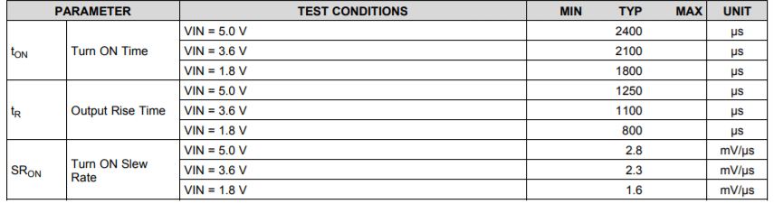

As title, is the TPS22919 rise time adjustable?

    The TPS22919 does not have an adjustable rise time, we spec'd the device to have a controlled rise time.
