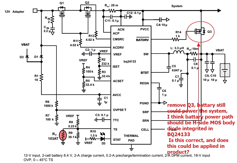

as mentioned, I design a 2 cell Li-ion battary charger, I have removed the P-MOSFET for battary, but the system still could powered by battary,
Then the question is : Does the system power could be powered by BQ24133 internal MOSFET body diode ?

Yes, the system power path is from BQ24133 internal H/S MOSFET body diode. See below photo for detail.
Battery power from SW pins then output to system from PVCC pins.
Please don't use BQ24133 body diode to provide system power source. it is not for power path purpose and will cause thermal problem.
