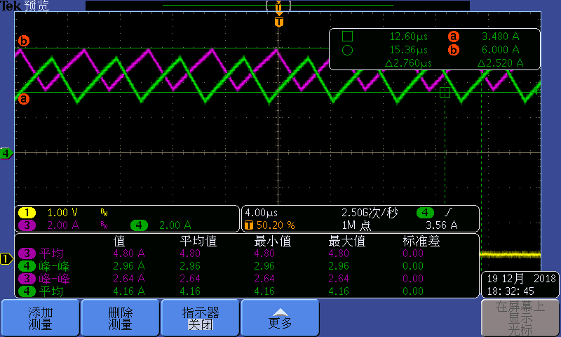

Hi team,
my customer use LM25119, but the two phase current is not balanced, please help.
Vin: 35V;
Vout: 21V Iout: 9A;
the difference of the two phase average current is about 640mA. how our part do the current balance function?
Robin Liu
  • Hi Robin,
    LM25119 is a peak current mode controller which has nature current balance capability.
    Due to sensing resistor tolerance and the variation of input offset of current sense amplifier, there could be slightly imbalance between two phases.
    I don't think the 640mA imbalance will be a problem for customer's system.
    Qian
