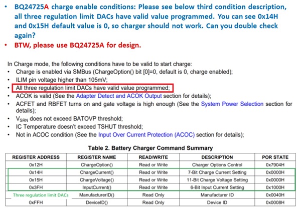

BQ24725: if the control CPU is power down, can BQ24725 charge to BATTERY lonely?
Part Number: BQ24725
when use BQ24725 as a charger, is it needed to config the charge current and charge voltage?
if the CPU is not power on ,can BQ24725 charge seperately  with no CPU controlled? i have not got enough info in the datasheet, please give some help.
thanks
