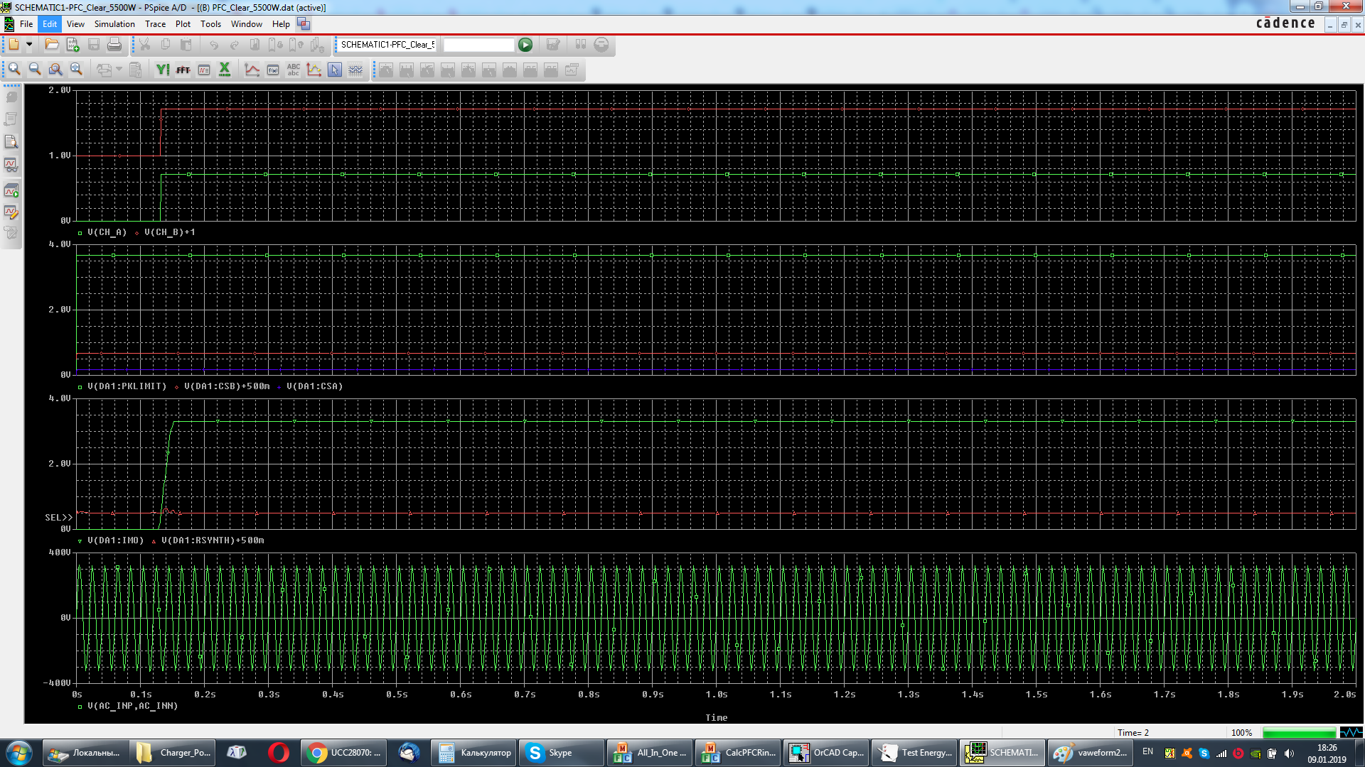

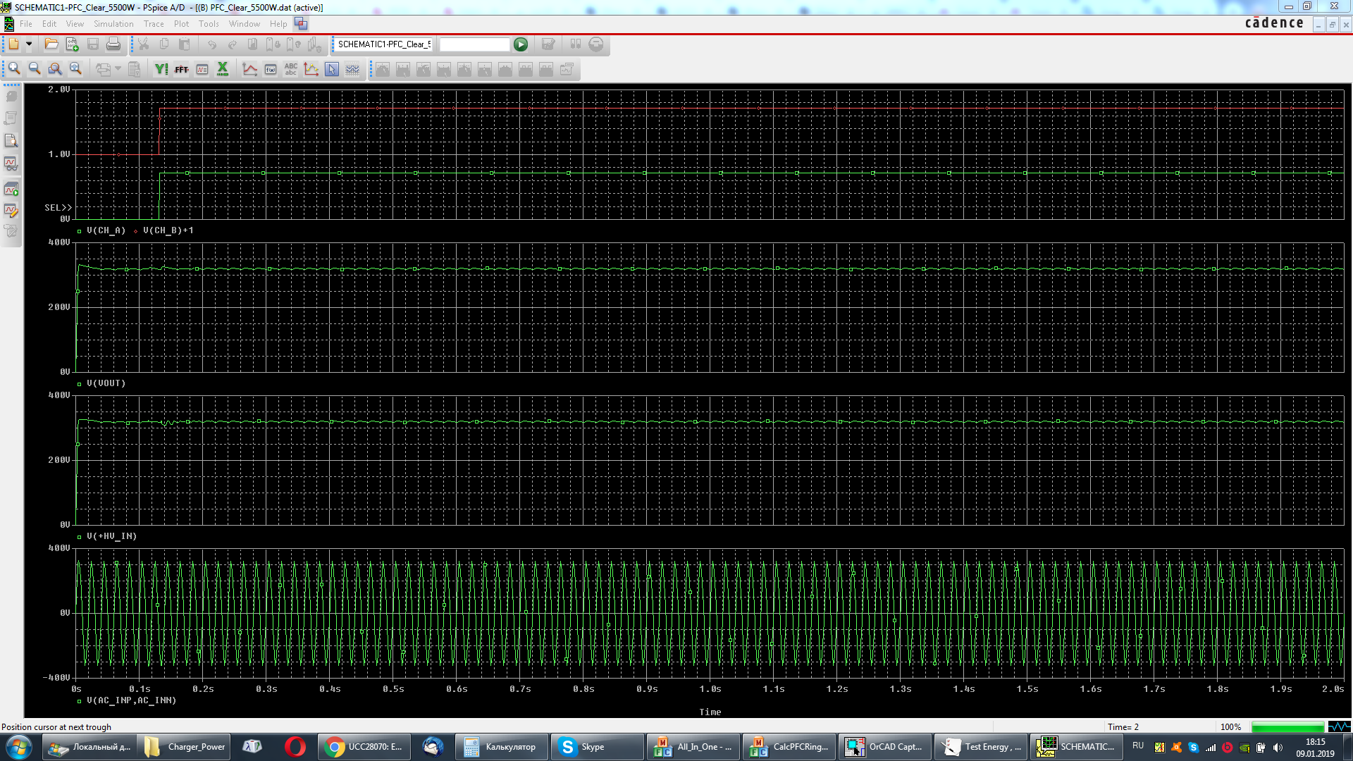

  • Thanks. Errors disappeared after offclude analise Fourier. But my simulation schematic doesn't work. Voltage on Chanel A and Chanel B equals some microvoltes. I'm tested with and without boost_block (parallel on my power parts). If used reference designe voltage on Chanel A and Chanel B have a sinusoidal vaweform whis amplitude 400mV. Because, i'm understand model UCC28070 Trans it's doesn't work on different designe power part, except boost_block?

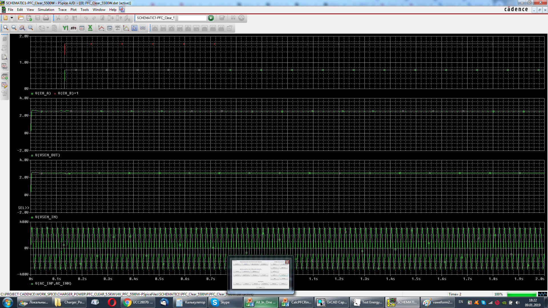

  • I'm create new project it's clear (but non use slum097 profiles reference designe). In a channel A and Channel B is a 700mV DC. I'm used Low-side driver UCC27524, unused pins (IRIPA/IRIPB/F_Khz) edit properties FLOAT to RtoGND.
    Waveforms simulations in my project and full archive my projectis attached on this message.

  • Thank you very much. But global problem this spice-model (not my project), i'm think, it's doesn't normal work out-pin of GDA and GDB ( more time this pin generate direct voltage ~700 mV, instead of rectangular pulses). This informations vision on waveforms in before posts.
  • GDA and GDB it's V_CHA and V_CHB on first screen before posts. The conditions for starting the chip are met.

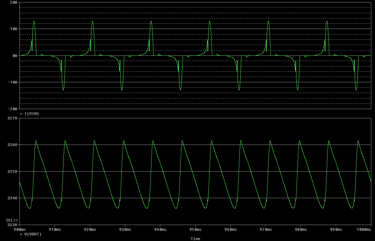

  • Hi Denis,
    We have looked into the project you shared and made the following changes.
    1. Connected IRIPA, IRIPB, FKHZ properly. Please look into the below thread to understand the functionality of these pins.
    https://e2e.ti.com/support/tools/sim-hw-system-design/f/234/p/153952/560486#560486
    2. Used BOOST_AVG block at the output stage.
    3. Configured input rectifier circuit properly.
    PFA the updated project UCC28070_PSPICE_TRANS.zip
    Below is the simulation result
    Thanks & Regards,
    Arpan Gupta

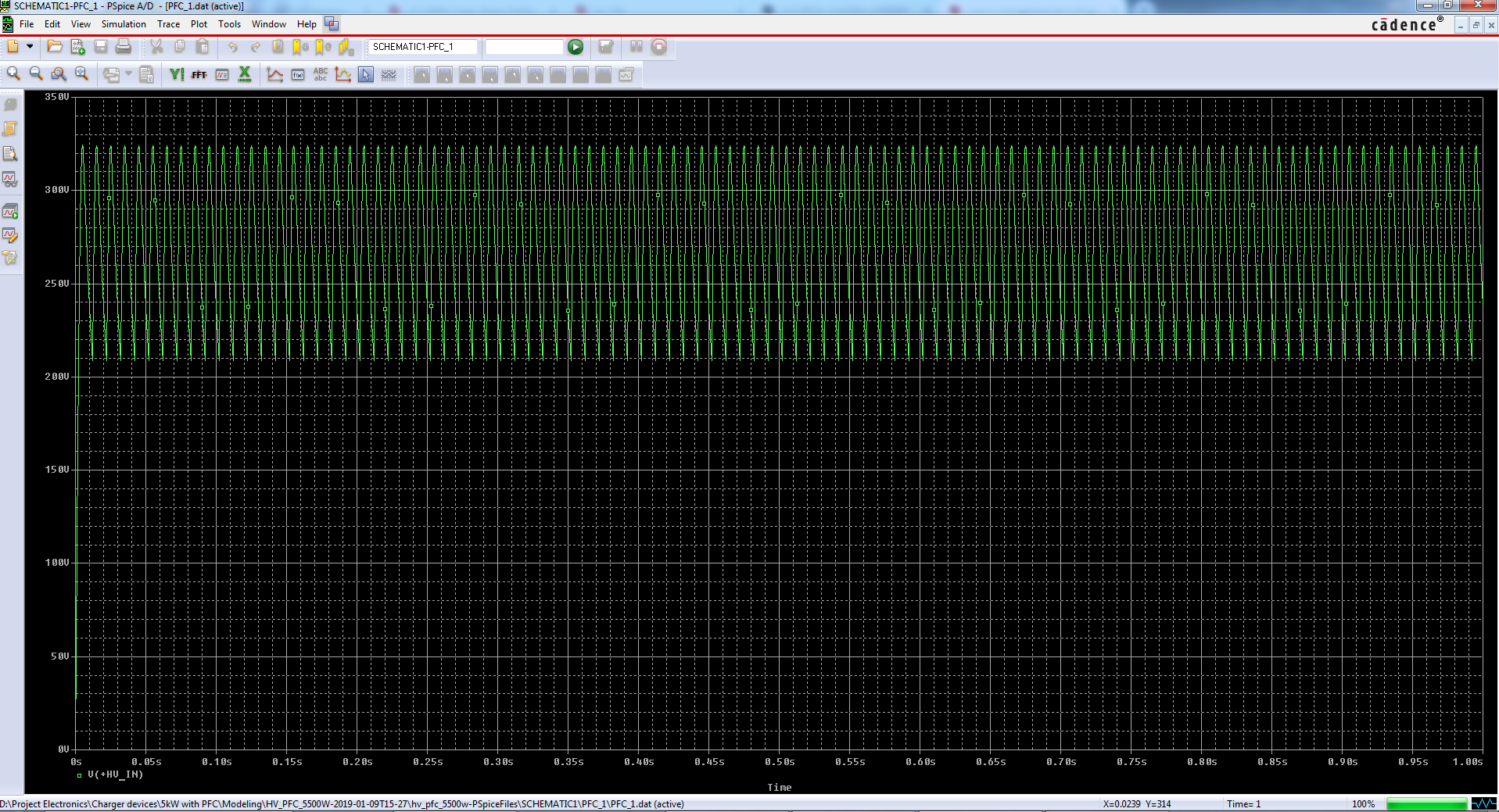

  • Good days. I dosen't have some problems whit the project used BOOST_AVG block. My problemes connects with using own FET (IGBT) and Inductor ( 60KMu cores), this project doesn't work in this model UCC28070. I need modeling transient processe in FET and feedback, and modeling magnetic parametrs in my cores, but doesn't want to search and stydy this process on finished devises.
