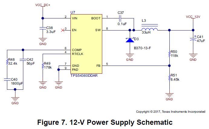

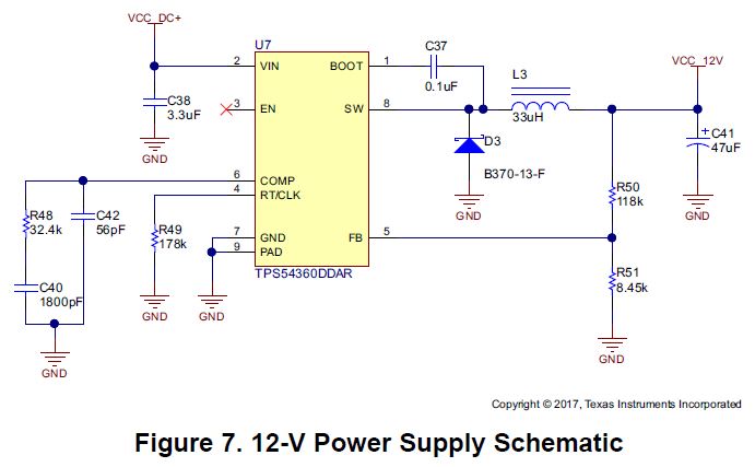

    I found TPS54360 in TIDM-1003 (as shown below).  Thanks for recommending TPS54360B, which seems a little different from TPS54360 in circuit design. Can TPS54360 be directly replaced by TPS54360B without any problem and getting better performance?
    For my targeted application, its rated power is similar to that of TIDM-1003. So I think TPS54360 may be enough for me.  But if you have newer converters, please feel free to tell me.  ^_^
    Could you kindly show me how I can modify the following circuit to obtain Vcc=15V output?

  • Tang,
    The B version is just more robust. It can be swapped out pin-for-pin for the non-B version.

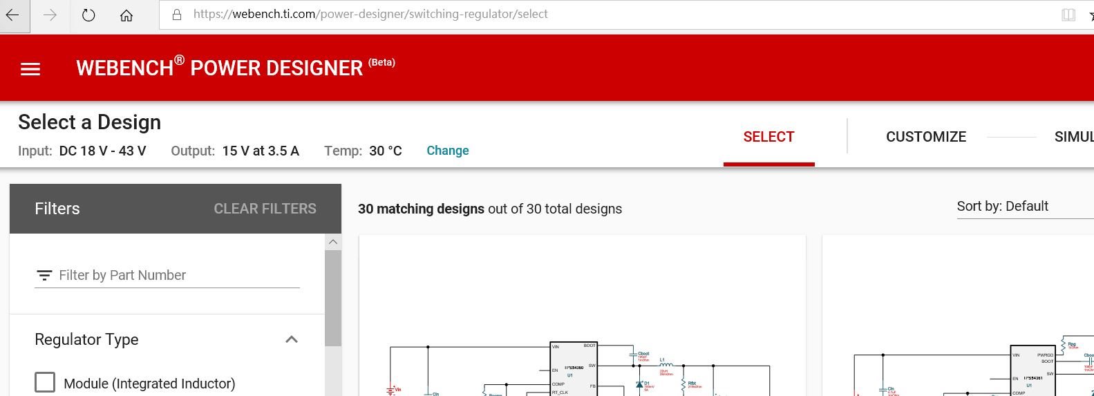

    You can set the output voltage (VCC_12V) to 15V by adjusting the feedback divider (R50 and R51) to achieve 0.8V (Vref in the datasheet) at FB when VCC/VOUT = 15V. That is probably all you will need to change but you can check your design with WEBENCH. Go to the product page of the part and enter your design specs in the WEBENCH box (on the right, scroll down a bit), then click to create your design.

  • Dear Sam:
    Wow! The WEBENCH is really powerful!!!
    Thanks for teaching me this wonderful tool!

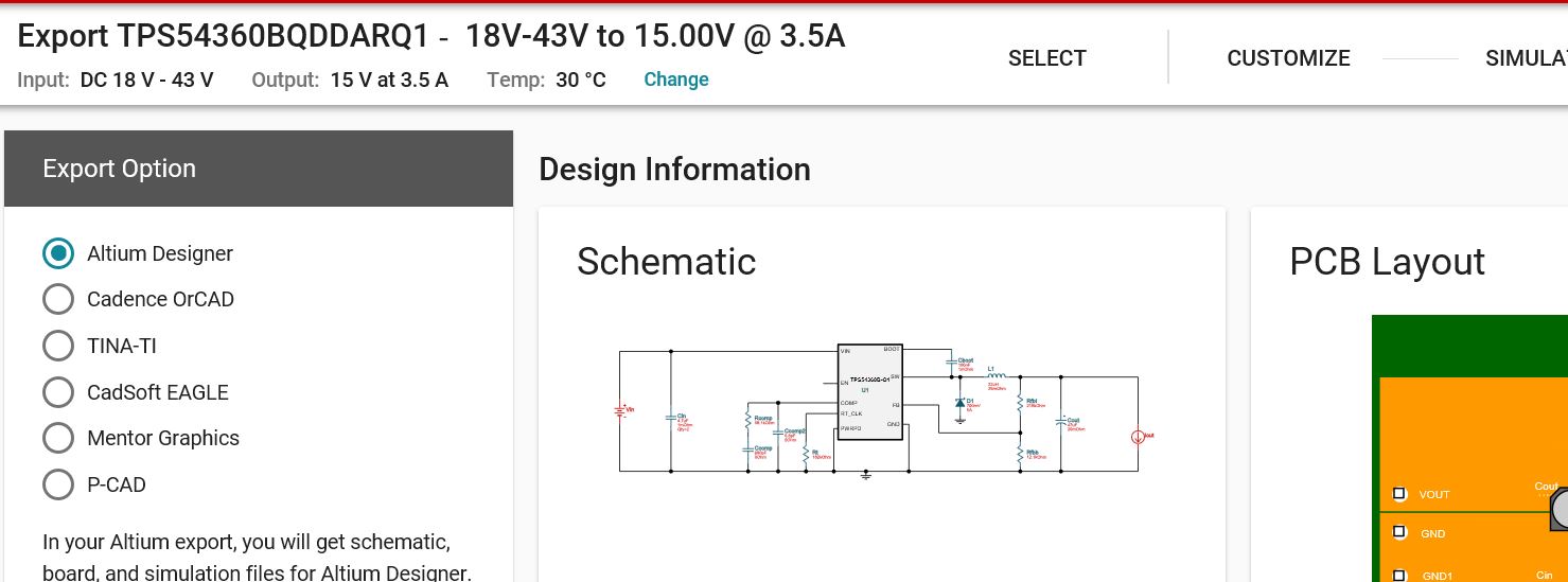

    Among the 30 matching designs, there are TPS54360, TPS54360-Q1, and TPS54360B-Q1..., but TPS54360B seems not found.
    So I will follow your suggestion to use TPS54360B-Q1. Do you think it is a good choice?

  • Tang,
    Yes, TPS54360B-Q1 is the best choice.
