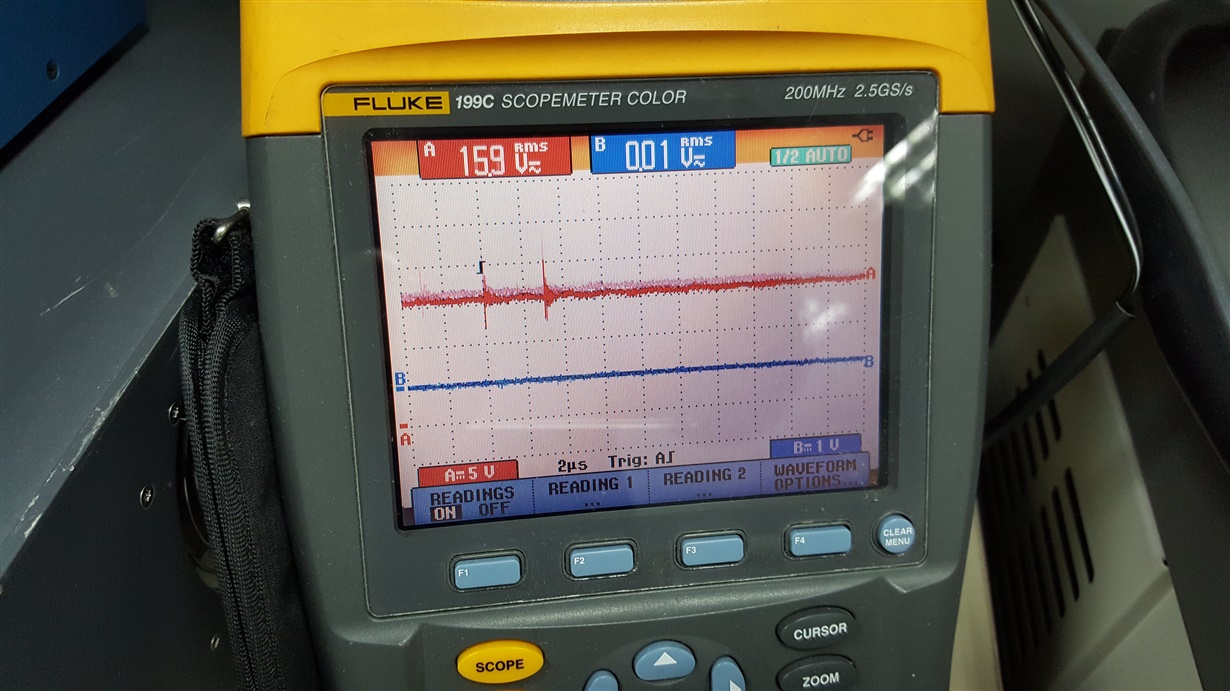

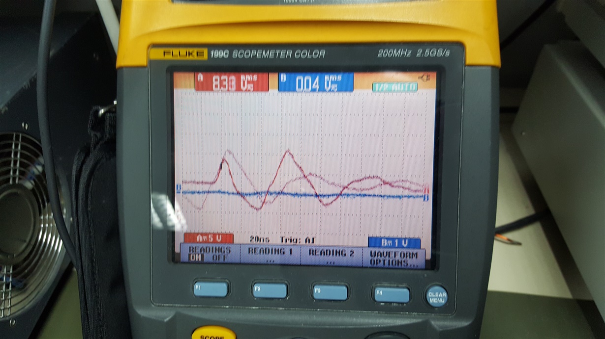

    In first picture we see the behavior of the output voltage at an input voltage of 70 - 130V. The output voltage is close to what I need - 15 volts, but sometimes short peaks of overvoltage up to 25V.
    Unfortunately, I can not attach more than one image in one message, so I will send the second image with another message

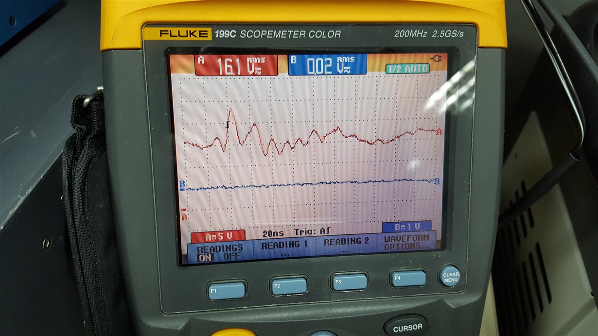

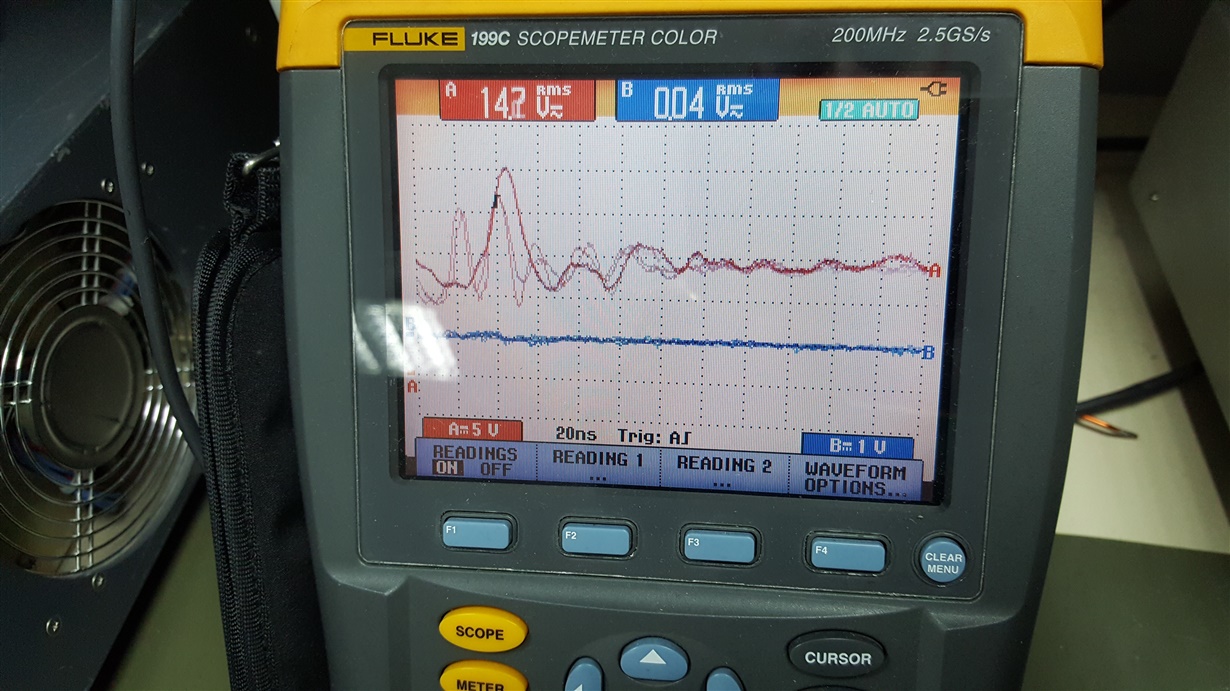

  • This is what happens when the input voltage reaches 130V
    Change happens abruptly.
    I hope this gives some information to think about.

  • Hello Leonid,
    Thank you for posting the 2 screenshots. They are a good start. The time scale shows 20ns/div.
    Therefore, my first impression of the peaking voltages is that they are noise induced on the scope probes during switching events.

  • Hello Leonid,
    The waveform on the 20ns/div scale is just switching noise, picked up by the scope probe GND "pigtail".  It is of no concern.
    The waveform on the 2us/div scale shows that same switching noise superimposed on a clean 15-V level.
    The noise amplitude will be much reduced if you make the measurement with the "tip & barrel" probing technique, which eliminates the GND-wire loop area of the probe.  At this point, I don't see any problem.  There will always be some residual switching noise due to output capacitor ESR and mostly from high di/dt through the cap's ESL.  Paralleling more caps will reduce it, but you don't need to do this unless the noise is causes system interference.
    If it is merely visibly objectionable, then it can become unnecessarily complicated and expensive to eliminate completely.
    Ulrich

  • Hello Leonid,
    From the waveform that you provided, it can be seen that the DC level is clean and stable over the 20us interval shown, except for 2 switching noise pulses. This noise is most likely pickup by your scope probe GND wire loop and the true peak-to-peak amplitude at the output capacitor is not actually as high.
    From your previous postings and descriptions, I will assume that the 220uF electrolytic output capacitor is the only capacitor that you have on the output. I recommend that you add a few additional ceramic capacitors in parallel with the 220uF cap in order to better bypass the high di/dt edge of the switching current and minimize noise peaks due to Cout ESL.
    I suggest adding a 1uF, 50V multi-layer ceramic capacitor (MLCC) and a 0.1uF, 50V MLCC, both with X7R dielectric characteristics.
    These small caps will have very low ESR and ESL and will help absorb switching noise over a range of high frequency harmonics.
    This should be enough noise filtering to confidently apply the 15V output to your logic.
    If you feel that this still is not enough, you can further add a series inductor of 1uH followed by another 1uF cap to GND to effect a high-frequency LC filter on the output. The feedback network for the FB input should remain connected to the larger 220uF Cout.
