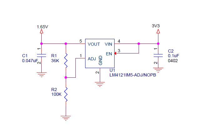

I am using LM4121IM5-ADJ/NOPB in our design for 1.65 Voltage Reference.
I selected the resistors R1 = 36 K ohms and R2 = 100K for the VOUT = [Vref(1+ R1/R2] − Ibias• R1. Vref =1.216 and Ibias = 40 nA
My expected VOUT is 1.65 Volts but I am getting 1.60 V
Could you suggest how to resolve it?
