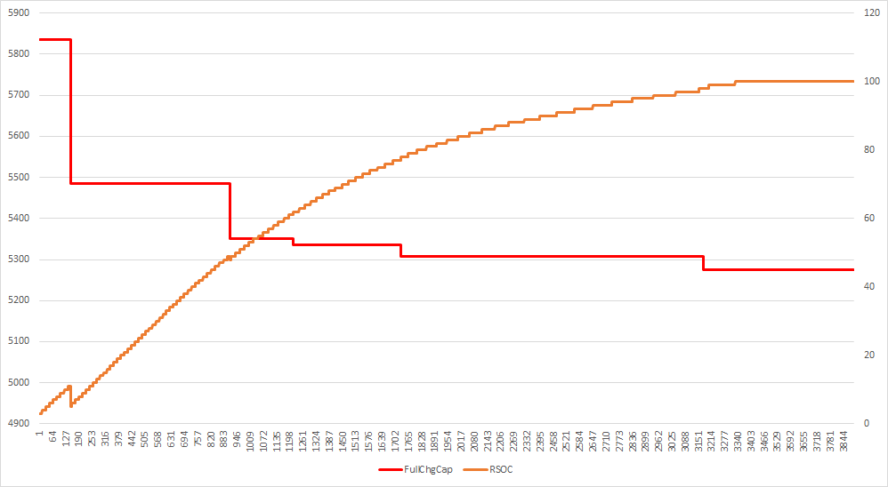

I'm using a battery pack 2p1s Panasonic NCR18650BF and I have completed the learning cycle succefully. During the charge of battery the Full Charge Capacity changes and I don't understand why.
Below the log of the charge exported from bqstudio
What am I doing wrong?
