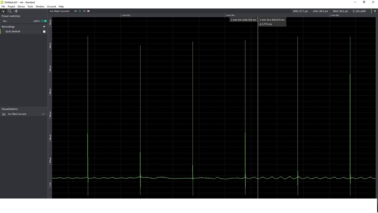

I am using BQ35100 in my design to monitor a single cell LiSoCl2 battery. I measured that the current consumed by BQ35100 when GE=0 is around 40uA, with a 600uA peak every one second. As per datasheet,the current consumption during GE=0 should be 50nA. I have isolated all other parts in the circuit to ensure the power consumed is by BQ35100. Can anyone please help me to understand what am i missing here?
