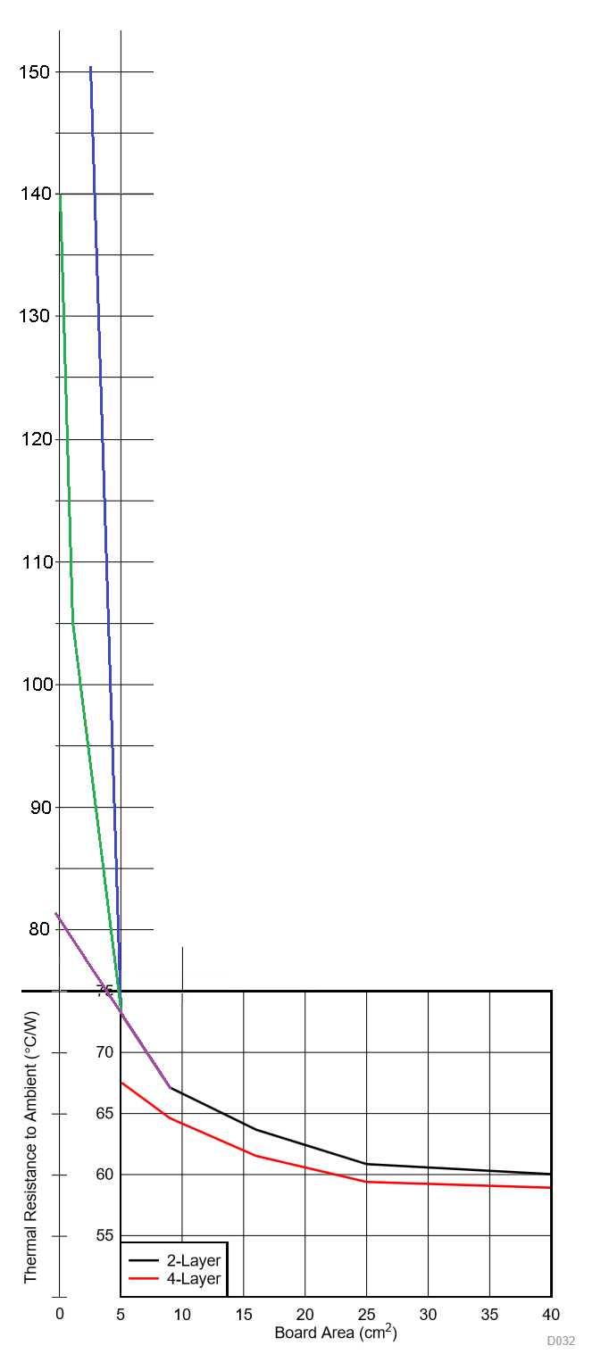

In the datasheet, Figure 7 and Figure 69. Package Thermal Resistance vs Board Copper Area, No Air Flow both express the Board Copper Area in square CENTImetres.

    In this case you are running 36Vin to 5Vout conversion at 0.35A with a maximum ambient of 35degC. The data shown in Figure 69 are actual lab bench thermal readings. Though the graph does not include any board area less than 5 cm^2, we can extrapolate a rough idea of what the board area should be for less than 5cm^2 Looking at the graph it is similar to an exponential decay. I'd expect no more than 150C/W at 2.5 cm^2.
    Since you are running relatively low power dissipation application of 0.35W and low ambient temperature of 35 degC I don't think the need for a big copper area is warranted here. Following the datasheet equation you would need to design a board with less than 257 C/W which with extrapolation of the graph I don't think would be an issue for you unless you are planning on making the PCB area as small as the nano module itself. I can go back to the graph and get the equation that would best fit the exponential decay patterned curve you see in Figure 69 to get a more specific number for you.
    If you had a specific copper area in mind, I can run this by the graph to see if it falls within expected extrapolated range of the thermal resistance below 20mm x 20mm. In short with your application requiring a board size with thermal resistance lower than 257C/W I don't think you should see much issues designing a board smaller than 20mm x 20mm.

  • I already tried extrapolation.
    Mathematical extrapolation
    Looking where the curve in Figure 69 has 'sharp' bends, it seems the following datapoints have been used for the 2-Layer PCB:
    4 73
    9 67
    16 63.5
    25 60.75
    40 60
    My best fit through these 5 points would be: R_theta = 59.85 + 22.875 * exp( -0.126 * A ), with A the copper area in cm^2.
    Shrinking the copper area A to zero yields a maximum R_theta = 59.85 + 22.875 = 82.7 C/W
    but, I question this best fit, because of the low number of datapoints in the relevant area (between 0 to 10 cm^2) which really determine the curve.
    Graphical extrapolation
    I neither can easily make a good graphical estimation. I also added your "no more than 150C/W at 2.5 cm^2.", which indeed seems quite high (note that R-theta in the Figure 69 starts at 50 C/W).
    I think i'll just try my current design

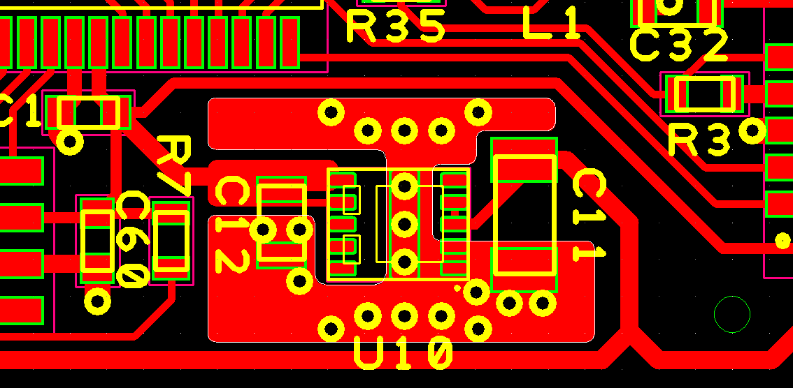

    which has a top copper area of 0.45 cm^2 and a bottom copper area of 10 cm^2 (but i expect only 2 cm^2 of this bottom copper area really contributes in lowering the R-theta).

    The board area occupied by the LMZM23600 solution is very small. As you have seen, only an input and an output capacitor are needed to get a 5Vout design. Thermal design is an important part of any power converter design. Usually the PCB copper is utilized to dissipate the power loss from the conversion process. The amount of necessary copper will vary with the application conditions (e.g. input voltage, output voltage, output current, ambient temperature, other hot components on the PCB, etc.). Section 11.1.1 of the datasheet tries to highlight this and provide some guidance on this.
    With that said, for your design it looks like the power dissipation is around 0.35W. Based on your conditions, you can have as high as ~250C/W of thermal resistance before the device reaches the maximum of 125C. If you have 10cm^2 of bottom GND copper, I feel that should be enough to achieve this thermal resistance.

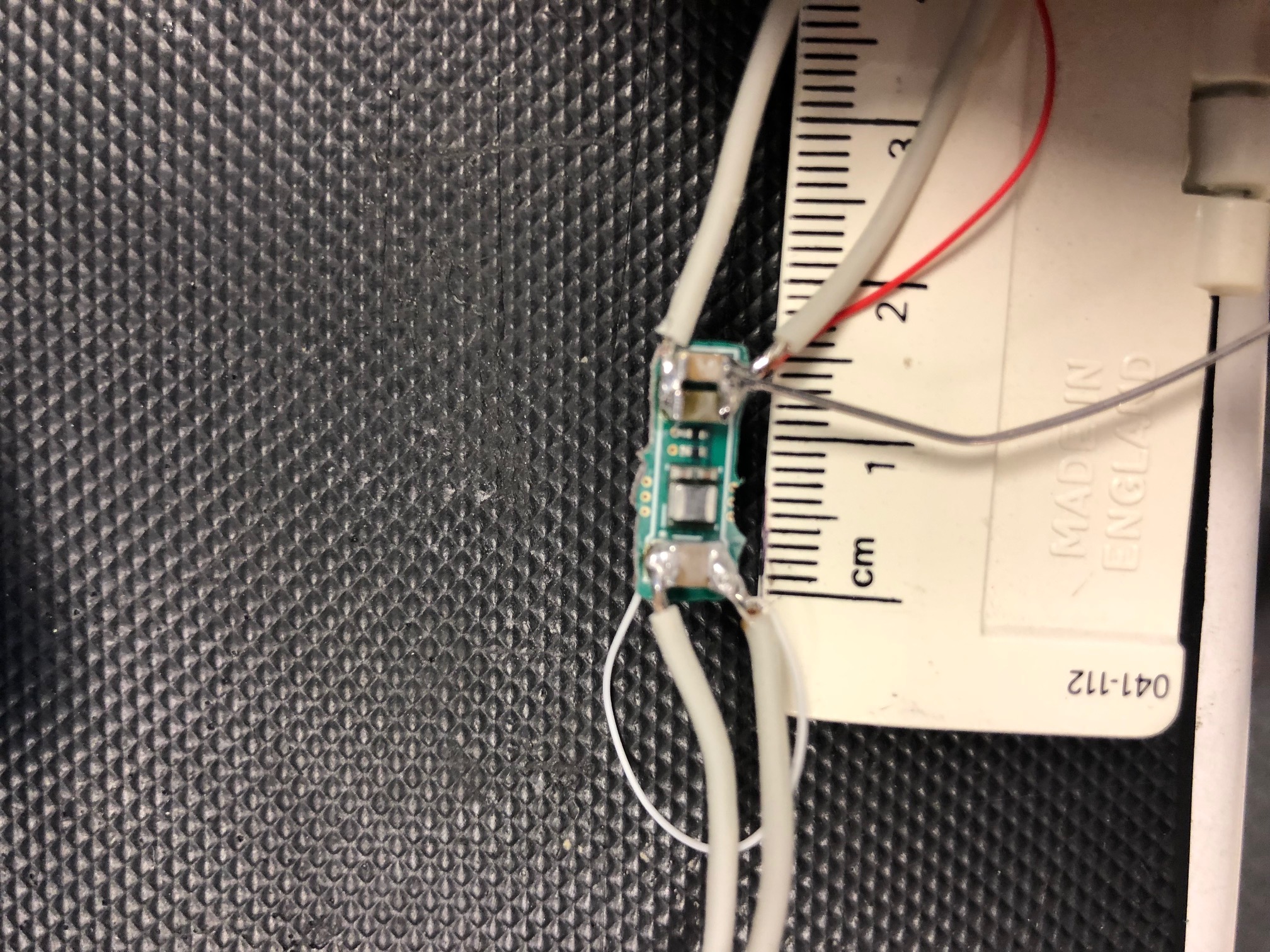

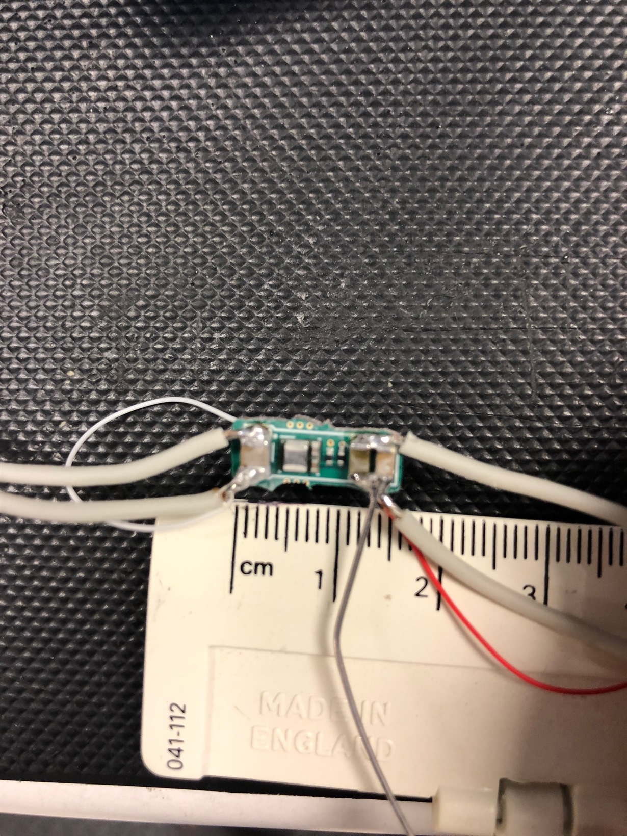

    Here is one example where we trimmed the evaluation board PCB of the adjustable output voltage version of the device to the following dimensions:
    With this board size and 0.5W of dissipation in the package, the temperature of the device reached close to 75C at room temperature:
     I hope this additional information will be helpful.
