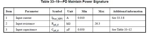

Please let me know about position of connect MPS resister (less than 26.3kΩ, parallel with 0.05μF).
I guess primary side because 802.3at standard is described below;
I think that the other idea is connect load resister on secondary side and continuous 10mA, is it no correct?

  • Hi Satoshi,
    Please see the circuit we propose in section 3.6 of our adapter OR-ing app note (http://www.ti.com/lit/an/slva306a/slva306a.pdf). The zener diode prevents the dummy resistor from spoiling detection & classification.
