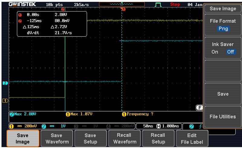

we use TPS65094, but we measurment PCH_PEROK sequence is greater then 125ms.

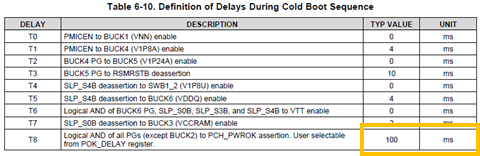

i saw the datasheet page 42. sequence was 100ms
measurment sequence:
GUI can change timing? or need PMIC heardware to setting?
