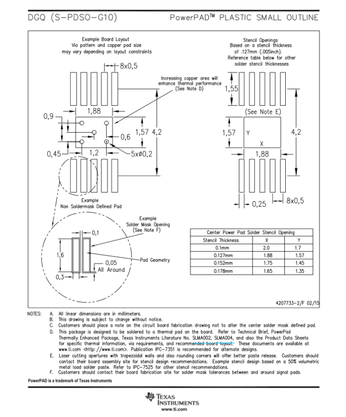

TPS54260: mechanical data
Part Number: TPS54260
Hi sir,
The mechanical data in datasheet(http://www.ti.com/lit/ds/symlink/tps54260.pdf) made me confused. Detail is that the mechanical data in page 50 and page 52 have the same headline and different size of package. which one should I take a reference when going on layout. Could anyone help me understand it? Thanks.
Jenny
