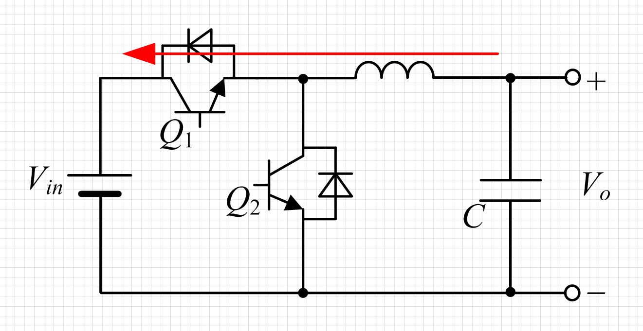

im using the TPS56628DDA regulator part in my board.for this regulator 12v is giving as Vin & EN and generating the output of 5v.
while im giving 5v to the power rail from usb type c and not giving power to the regulator input ,it becomes floating and backdrive happens getts 5.5v in the 12v power rail.
so how to avoid the backdrive of the regulator ?give me some solutions for that.
