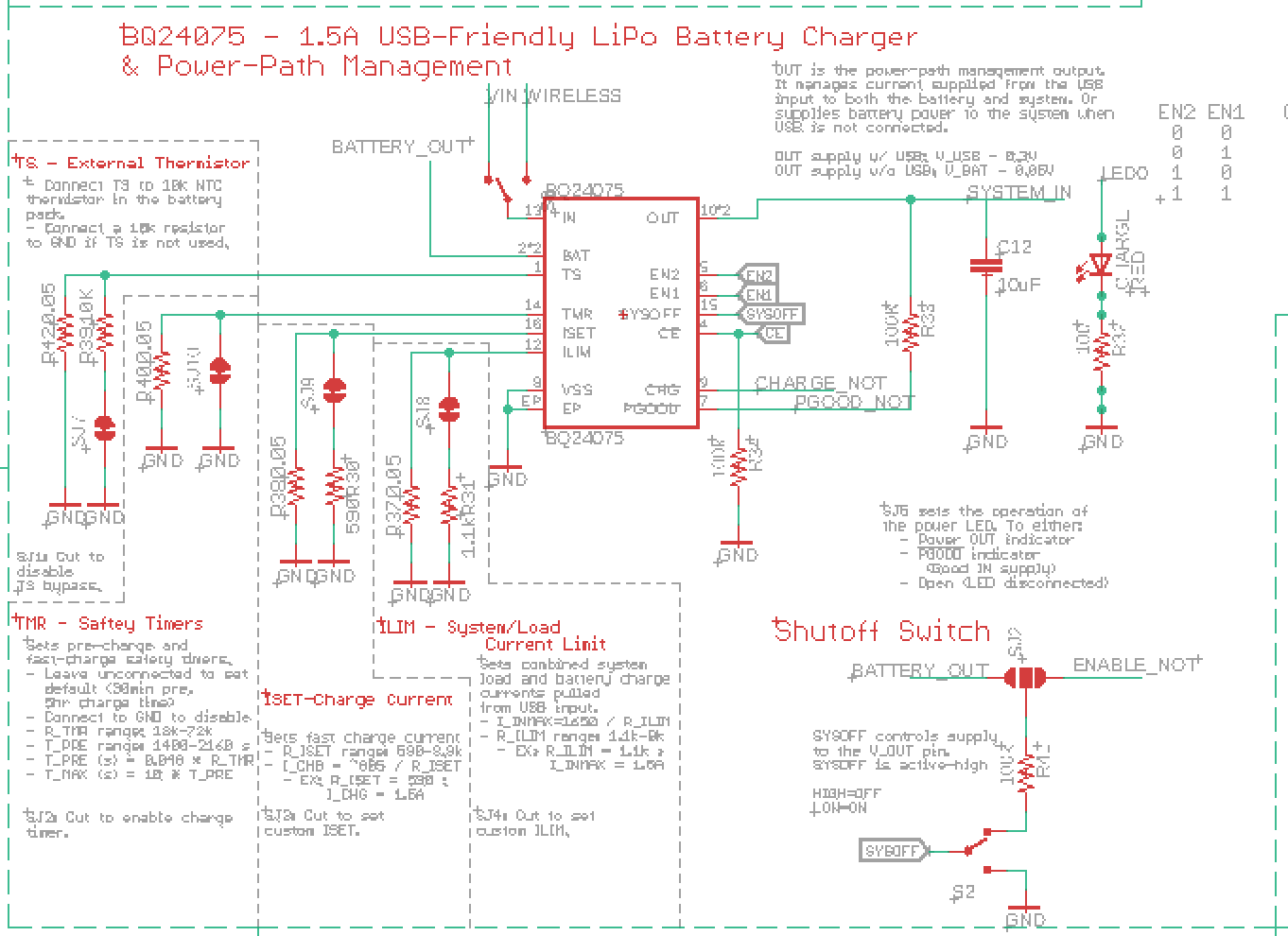

We made a circuit design in which we use the BQ24075 power management chip. However we encounter some problems with charging the battery.
We use a 5V adapter and we do see proper changes in /PGOOD.
But the voltage at the pins of ISET, ILIM and TS are zero.
The enable pins are both set to zero volt.
Does anybody know what might be the problem?
