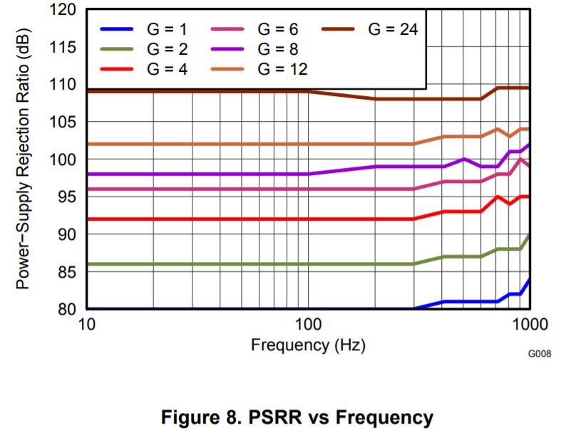

    I appreciate the super quick response.  I don't know the frequency of the signal they are monitoring but I do know they are using the TI ADS1299 at 500 SPS, so we can assume the frequency they are measuring is in the 250Hz or less range.  I believe that is what is driving this large PSRR requirement.
    I have also asked them for more details on what is driving this PSRR requirement since the ADS1299 is showing a PSRR performance of over 100dB at 100Hz for a gain of 24 that they are using. So between the PSRR of the TPS63710 and the ADS1299 they may be okay.
    They are using a +5V supply and need to generate ±2.5V rails for the ADS1299 (both positive and negative). These are low current rails needing 10-20mA max. It looks like the TPS63710 device is a 1A device which will be a bit of overkill for this application.
    Last thing, one thing I was concerned about with both the LM27761 and LM27762 is that they both have a 2MHz switching freqeuncy. This is right at the modulation frequency of the ADS1299 and the decimation filter will have a gain right around 1 (will not reject this switching noise). See below.
    Let me know if you have any questions but my main concerns were to find a inverting regulator that doesn"t switch near the sample frequency and doesn't switch near the modulation frequency.
    Let me know what you think and thanks again,
    John
