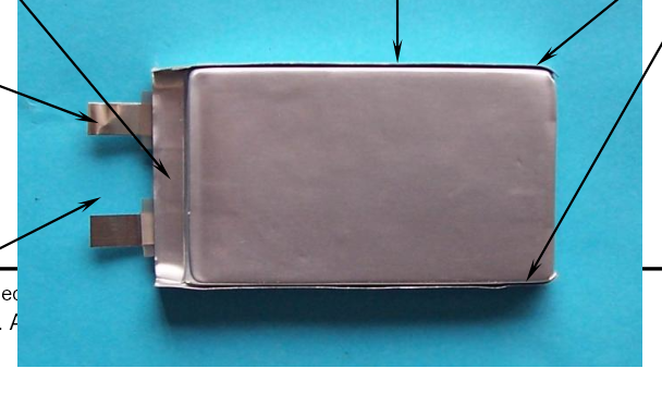

i have completed chem id cycle and got a report. any one can please double check that the chem id which i get is good for my battery or not.
Battery specification : Tenergy 3.7v 4600mAh Li-ion polymer battery
