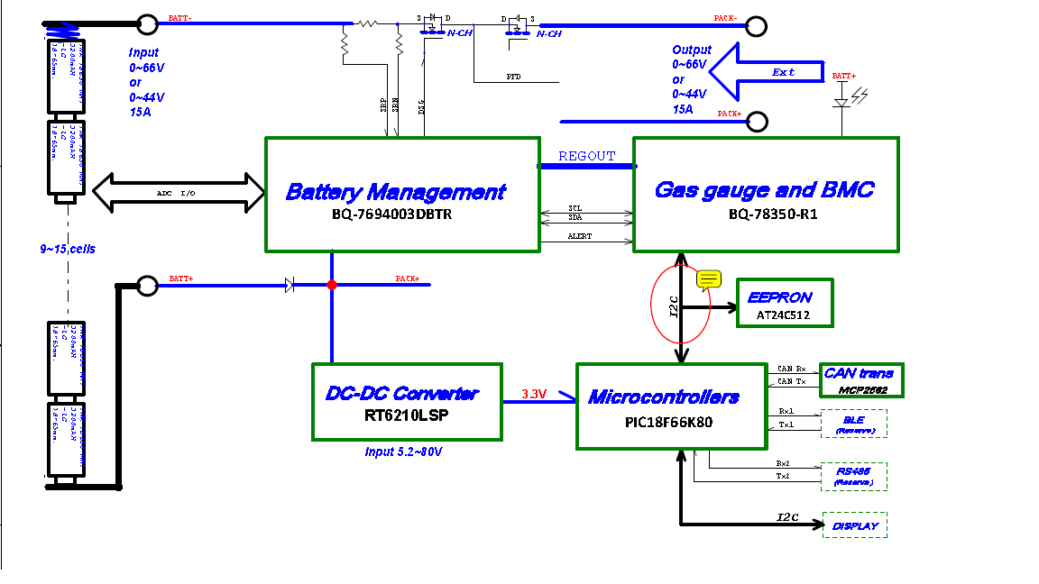

                        Customer block diagram as attachment.
                         They have some question.
                        1.They want to use MCP (PIC18F66K80) to drive bq78350 and control bq76930,  this MCU how to control bq78350 ?
                        2.How about bq78350 core size ?  if customer want to modify bq78350 FW what kind of toll do they need ?
                        3.If BQ78350 is hanged, how to reset ? (HW)
  • Hi Dustin,
    They can use an MCU to communicate with the BQ78350. This is a common approach used in many applications.
    I'm not sure what you mean about modifying the bq78350 firmware. The firmware instruction code cannot be modified. If they want to update to a different version of the published firmware or if they want to write the data flash in production, they can use the EV2400 with BQStudio or BQ-Hi-Production (I can share this tool with you if needed).
    The Reset command is described in section 17.2.33 of the TRM.
