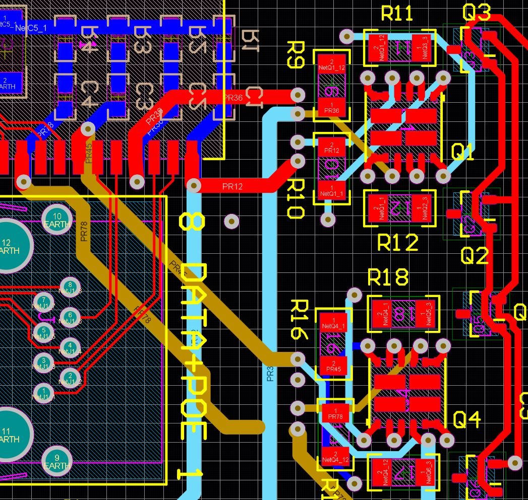

I have question on layout from transformer to mosfet
in SLVUB75,pdf
in figure 1,
can I route below trace together from "T1 " to "Q1" and "Q4"
the trace , PR12 , PR36, PR45, PR78
  • Hi Dimitry,
    Yes, you can route them together. See the picture below & figures 8 & 10 from the TPS2372-4EVM-006 User's guide for an example.

  • Hi
    Because the routing space is not enough , i have rout 4 trace closely.
    is there any trace width and trace space required ?
    And in chater 7.2 Layout Guidelines
    I see" Spacing consistent " and "No crossovers of signals " items
    So I wanna to make sure is there anything I should take care.
    thanks
  • Hi Dimitry,
    The traces should be sized according to max expected current, & traces should be separated according to the max expected DC voltage between them.There should be calculators on the web that can recommend these measurements based on the safety standards.
    You are referring to the two statements from 10.1 of the TPS2372 data:
    - "There should not be any crossovers of signals from one part of the flow to another."
    - "Spacing consistent with safety standards like IEC60950 must be observed between the 48-V input voltage rails and between the input and an isolated converter output."
    The 1st statement is saying not to cross signals from different section of the circuit. For example, you would not route an input signal underneath the noisy switch node at the drain of the primary FET. Having the input traces close to input related components is recommended.
    The 2nd statement is addressed by my first comment.
