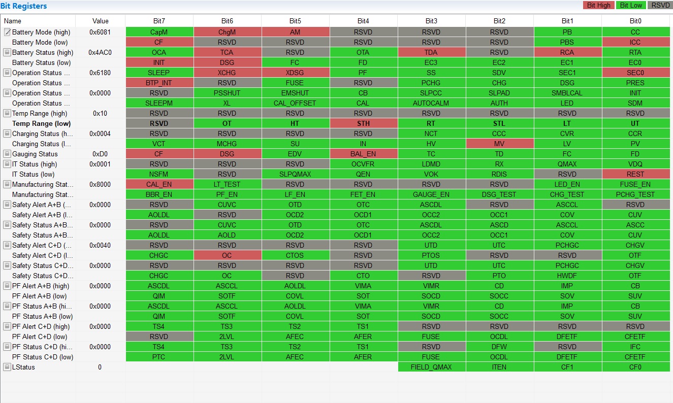

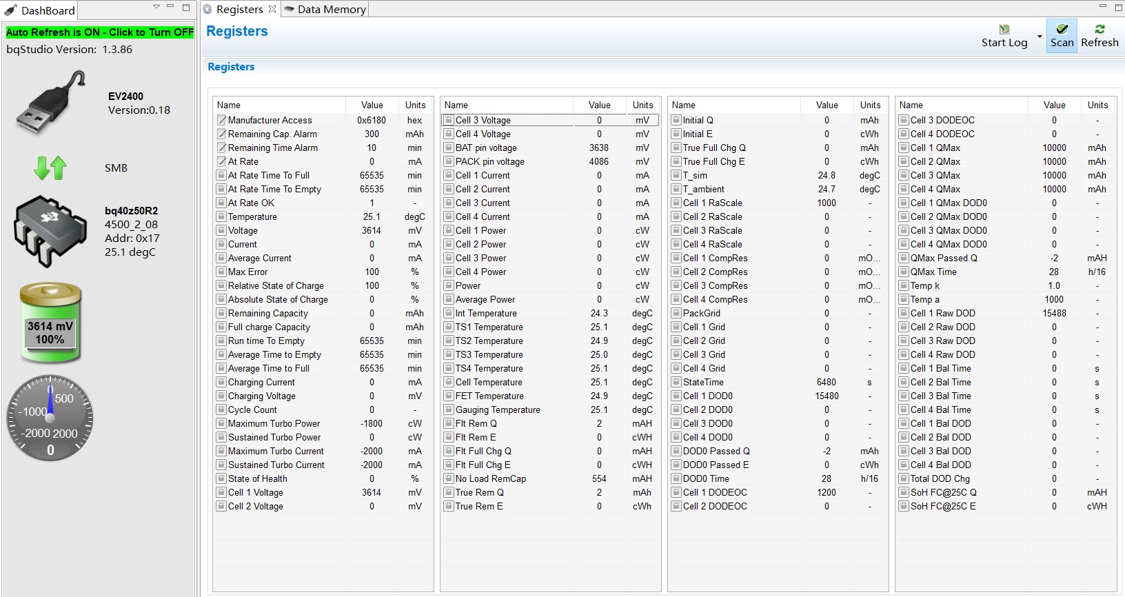

I used BQ40Z50_r2 for a 1S5P Li-battery(18650). The firmware version is <08_build_50.srec>.'Design capacity mAh' was 10000,'Design capacity cWh' was 3700.'Design voltage' was 3700mV.'Dsg current threshold'&'Chg current threshold' were 5000mA. 'DA configuration' was set as 1 series battery.Other parameters were almost default values. I have the following questions:
(1)I used 'CHEM ID' command in 'Commands' list to get chem ID. The result is 0x1210(decimal:4624). I cannot find the ID from your library. Can offer me?
(2)'Max error' and RSOC were all 100%, but ASOC was 0%, RC and FCC were all 0mAh. How to modify?

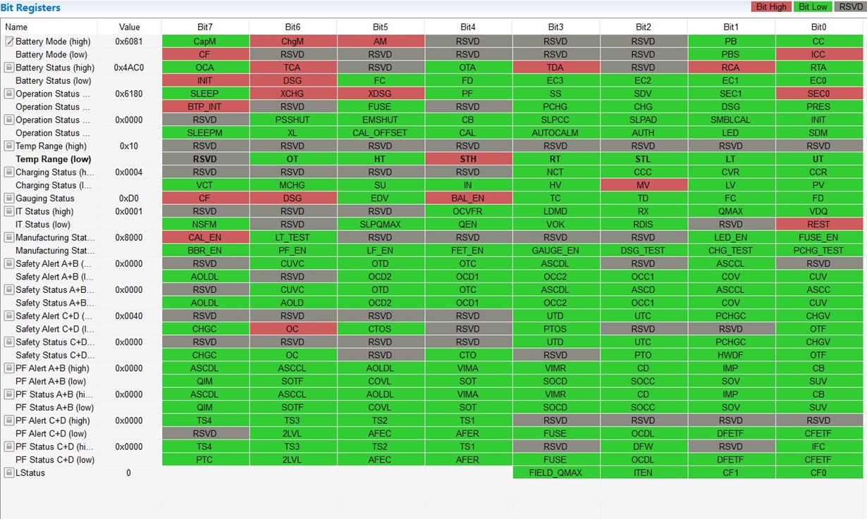

(3)Cannot charge. CHG MOS was turned on, cell/pin voltage is 3.62V, PACK  connected 4.0V source series with a 1Ohm resistor. How to do?
(4)How to do learning cycle?
