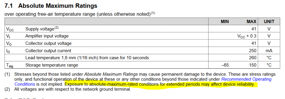

Hello team,
regarding the TL494ID PWM CONTROLLER VOLTAGE MODE SOIC16, if I ook into the maximum collector current, do I find the peak max current or average max current?
Can I use the device at absolute max value (collector current) for a prolonged time?
Thank you and best regards,
