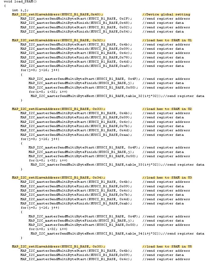

How Via I2c we are sending data to SRAM ?
According to Manual ,
1. The compile tool (Lasm.exe) will generate Hex file
2.Then, copy the hex file to the array table
3.upload the data to the SRAM by the below coding.

What address we are using to pass the data Patterns to SRAM ?
  • Hi, Srinivasan,
    You need to send the data to the corresponding device.
    As you can see from the user manual, it uses 40h for global address and 32h/33h/34h/35h for each device to send the corresponding data.
