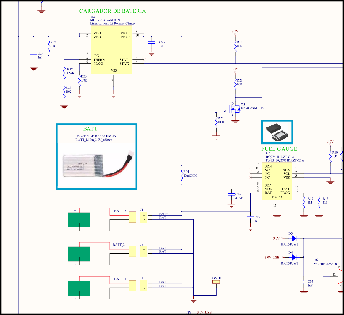

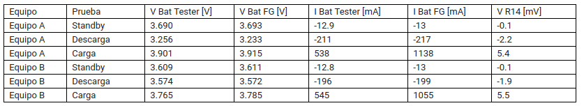

We are using the BQ27411-G1A to monitor the SOC of our batteries. We are manually setting all values in ROM. Everything is working fine except the current measured by the fuel gauge when it is charging the batteries.
When discharging, the fuell cell measures with great accuracy the current flowing trough the 10m Ohm resistor. Never the less, when the batteries are charging the fuell cell reports approximately double the current that's flowing through the resistor. We have measured voltage drop across the resistor and also measured the current flowing trough the resistor and comparing it with the value reported by the fuel gauge, yielding the following table:
We tried two different devices with the same results "Equipo A" and "Equipo B". V Bat Tester is the voltage of the batteries reported by a tester, V Bat FG is the Voltage reported by the Fuel Gauge (FG). V R14 is the voltage drop in the 10m Ohm resistor measured with a tester.
As you can see, the FG reports an incorrect value for positive values of current (batteries charging). We are also sure it is reading current incorrectly, because when charging the Remaining Capacity reported by the Fuel Gauge increases to approximately double the design capacity. In the file "serial_20181222_144052_carga.txt" we have monitored the FG behaviour when charging from a full discharge.

We are using two Li-Ion 3.7V 680mAh batteries connected in parallel. Here are the schematics of our design regarding the Fuel Gauge:
