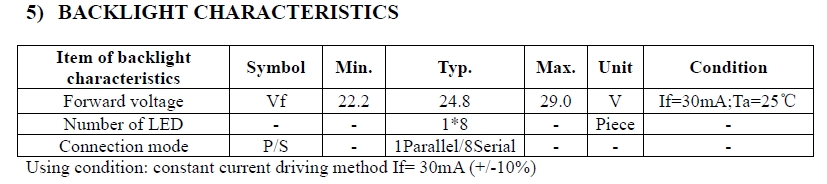

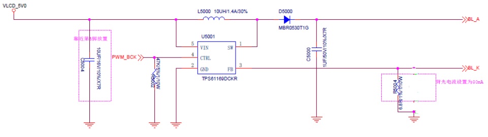

Issue description : My design is  use a TPS61169 to drive a LCD backlight circuit (LED number 1*8,Vf(typ)24.8V@30mA ). I find these is very few IC(10/10000) occurs different drive current when we use 1%  PWM input at Ctrl  Pin (24Khz,3V3 voltage level ) ,the LCD backlight show a lower light brightness,but  the same  Vfb value appears at 100% PWM input. I switch the IC  to another good PCBA,the result is whatever the PCBA we used the failure is always appear at same IC.
measure data&circuit detail :
abnormal  IC         1% PWM input                  Vfb=2mV                      Vout=20.4V       ( Rset=6.8R        L=10uH/1.4A   Diode MBR0530)
                              100% PWM input             Vfb=203mV
noraml IC              1% PWM input                  Vfb=11mV                     Vout=21.1V       (Rset=6.8R         L=10uH/1.4A   Diode MBR0530)
                              100% PWM input             Vfb=209mV

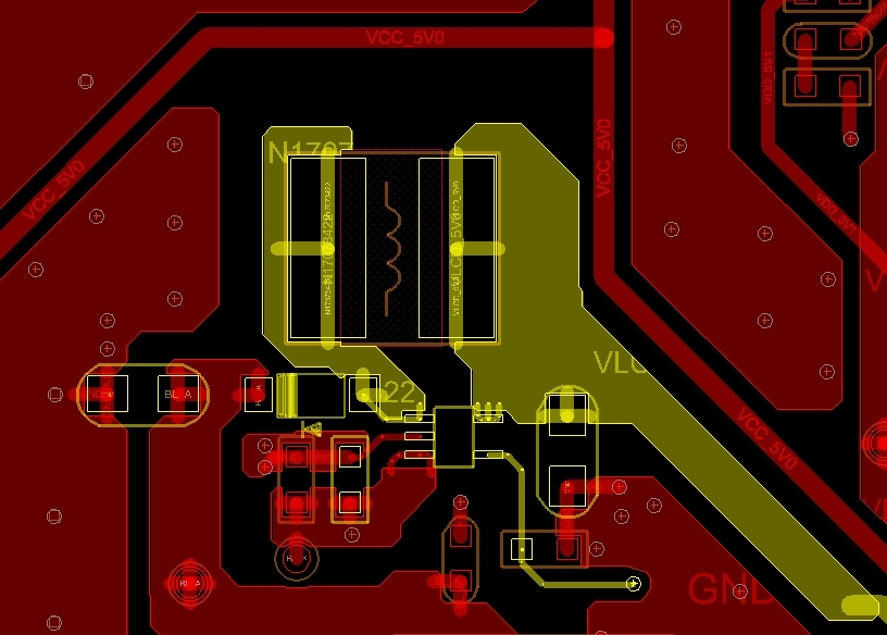

layout picture :

1. It there any problem  in circuit design and pcb layout ?

  • Hi ,
    Thanks for using our TPS61169, for your question as below:
    1.The schematic and pcb seems ok from my side;

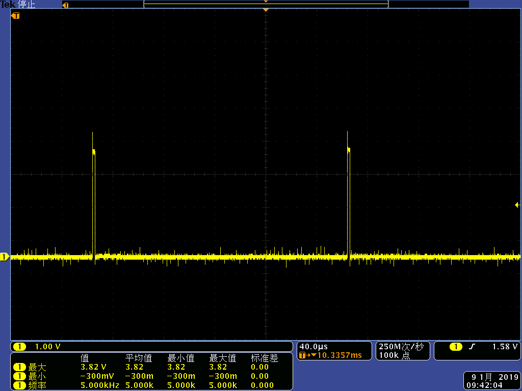

  • Dear Sean,
    Thank you for your feedback.
    We try to decrease the PWM dimming frequency that it been set at 5KHz at 1% duty cycle. But the Vfb difference is still there.
    The test data as below:
    abnormal  IC         1% PWM input (5Khz)                 Vfb=1.9mV                      Vout=20.4V       ( Rset=6.8R        L=10uH/1.4A   Diode MBR0530)
    noraml IC              1% PWM input (5Khz)                  Vfb=12mV                     Vout=21.1V       (Rset=6.8R         L=10uH/1.4A   Diode MBR0530)
    So, I think decrease the PWM dimming frequency is no efficiency for  1% PWM control .
