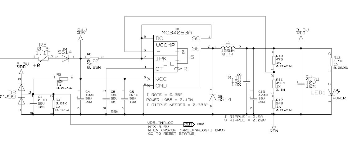

Dears
The measured output voltage frequency of the following circuit is 177khz, but according to the theoretical calculation, this value should be 96k.
I'd like to know what might be wrong with this circuit?
