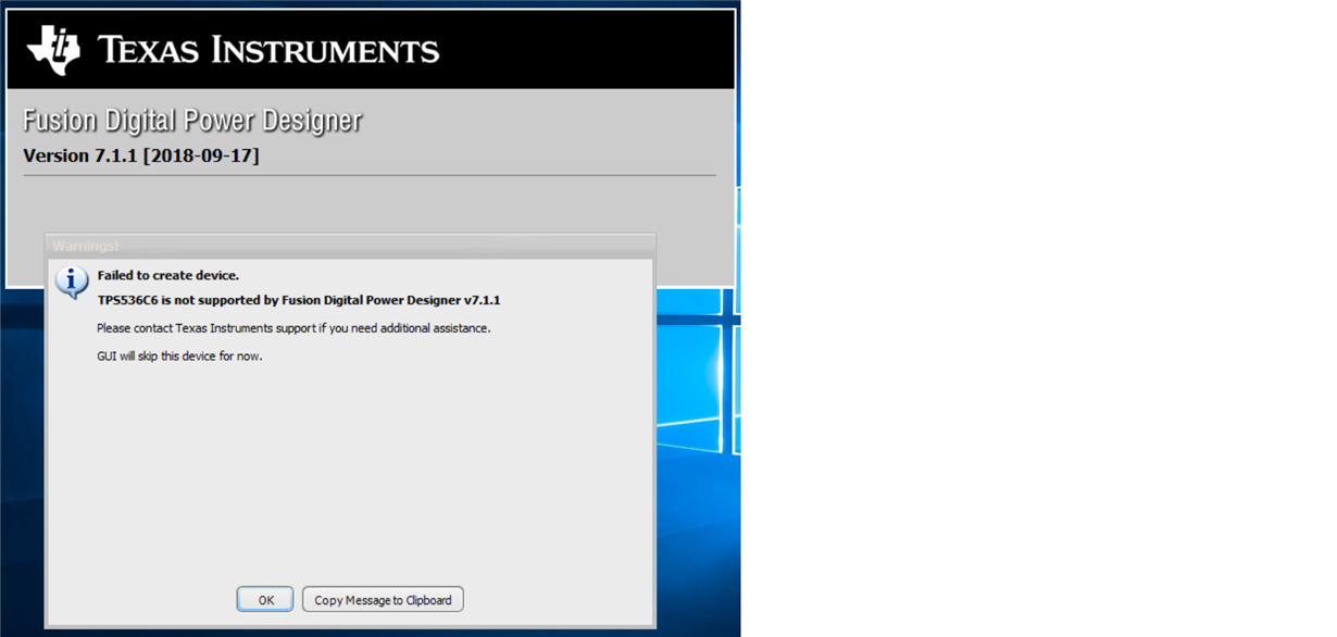

    2) TI Fusion Power Digital Designer
    About the TI Fusion Digital Power Designer (version 7.1.1), I used "Offline Mode" to open the *.xml file.
    But it displayed the error messages as follows:
    >> Failed to create device.
    >> TPS536C6 is not supported by Fusion Digital Power Designer v7.1.1
    About the details of the error messages, please refer to the attached picture.
    2-1) I received the *.xml from my colleague and he used TI Fusion Digital Power Designer (7.0.xx).
    2-1-1) And the *.xml file is for TPS536C6.
    Q2-2) Could you tell me your comment?
    Have a nice day.
  • Hello Hank,
    Please accept the friend request I sent you to connect privately. I can then share a beta version of the Fusion Gui that supports the TPS536C6.
    Cheers,
    Carmen

  • Dear Sir:
    I already downloaded and installed the TI Fusion Digital Power Designer v7.1.10.
    And it can opened the *.xml file for TPS536C6.
