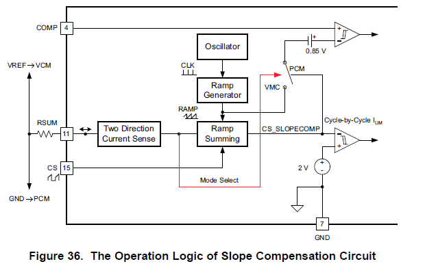

  • Hello User
    As noted in  section 7.3.14 in the Data Sheet, the signal at the CS pin is fed through a 30ns time constant to provide some leading edge blanking and is then added to the RAMP signal (for slope compensation) and then sent to the PWM and Cycle-by-Cycle comparators. There is no filtering applied to the CS signal so that the comparators will trip when the peak value of the signal reaches their respective thresholds (COMP-0.85V or 2V). There is a 100ns propagation delay from the CS pin to the outputs. This means that the outputs (OUTx) will change state 100ns after the voltage at the CS pin reaches the comparator thresholds (modified to take account of the 850mV offset and the slope compensation ramp of course).
    The block diagram in Figure 36 is a good representation of the system.
    Colin
